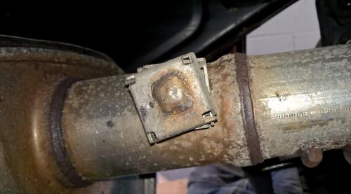

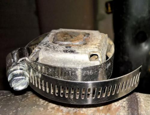

I found the valve and turned it a 1/4 turn and put a hose clamp around it to hold it in the open position. It seemed like the noise went away, but it was still there occasionally, so I can't say that that really made a difference. I took the hose clamp off and took it for another right and the noise was not there as often. I'm at a loss on this one. My wife took the truck to work today. I'll see what notices. Here is a picture of the valve, one without the clamp and the other with the clamp on.
I did notice that the noise only seemed to show up when in V4 mode, so it has to do something with that valve or that is just the engine making that noise when it is in V4 mode.
