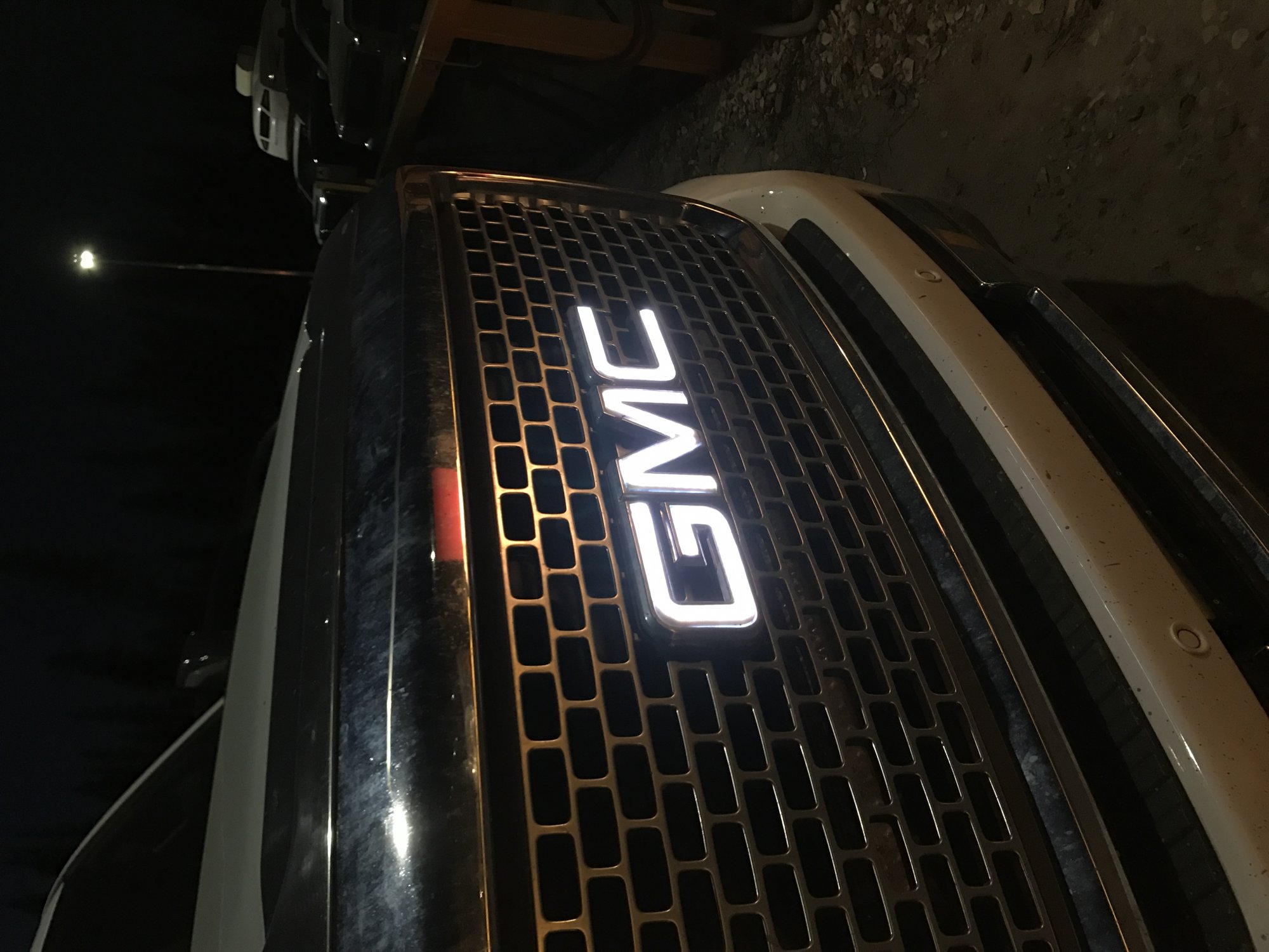

2ND UPDATE:
Ok, some trial and error (and beer) on this part. Epoxy makes a mess, don't do this on the dining room table like me, you'll get yelled at. I promise.
I used Opaque white dye and clear epoxy... "Environmental Technology Casting Epoxy"
Masking tape to cover the holes in the back.
I poured it 3 times before I got it right. then put a top coat on top of that.
mixing the epoxy correctly and keeping it warm while you do it is key.
It has anti-gassing agent in it, so the bubbles come out of it.
I then took a razor blade and began scraping off the epoxy on the outer edges. looks good so far.. now to try the led section of the project.

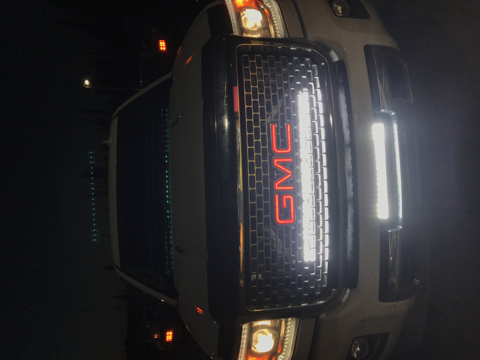

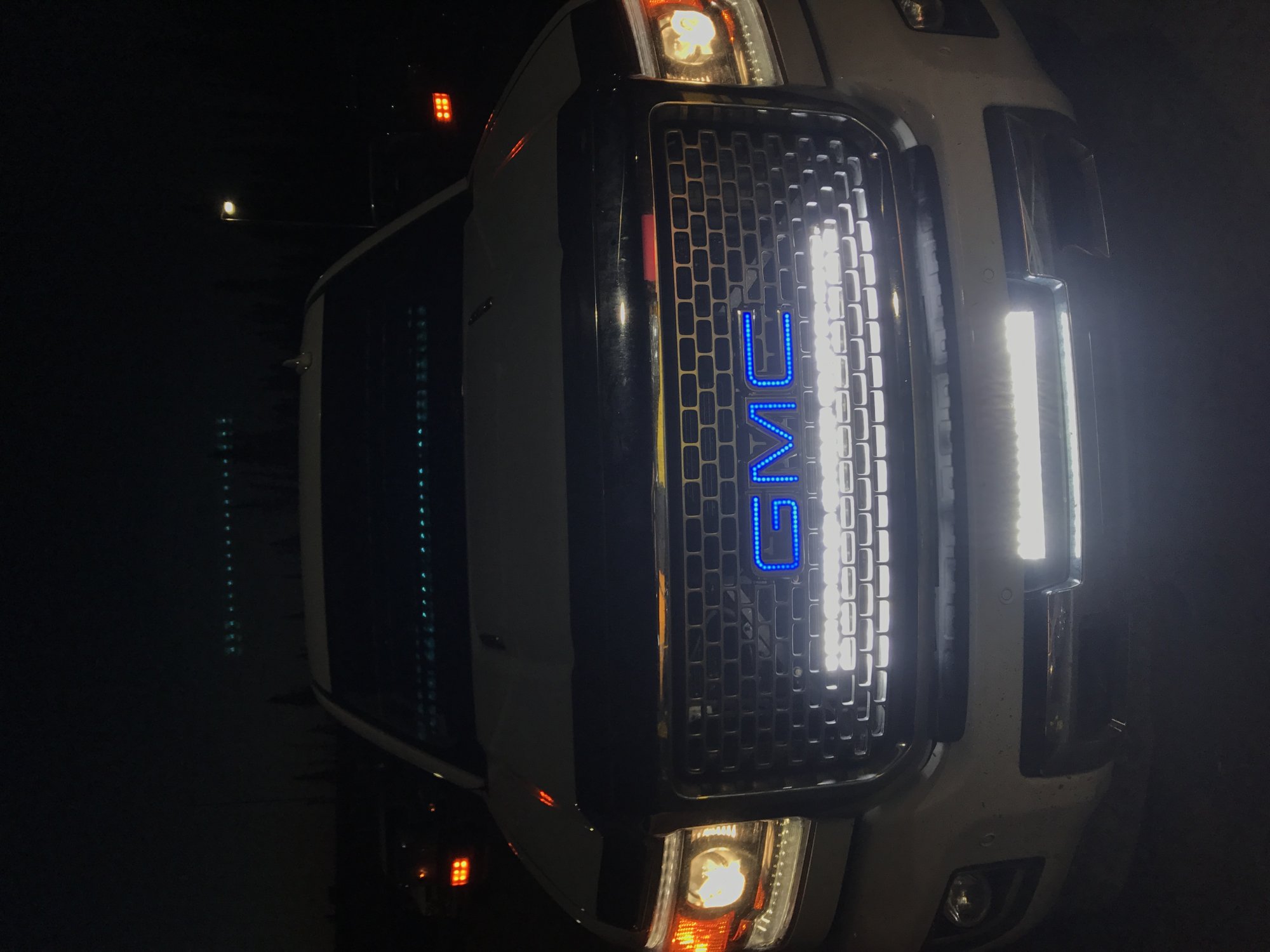

Thought I would try to build one of these but with a ws2812 led pixel strip this is what i have created so far
I am going to get myself a bluetooth controller so I can select any color and brightness and control it from my phone

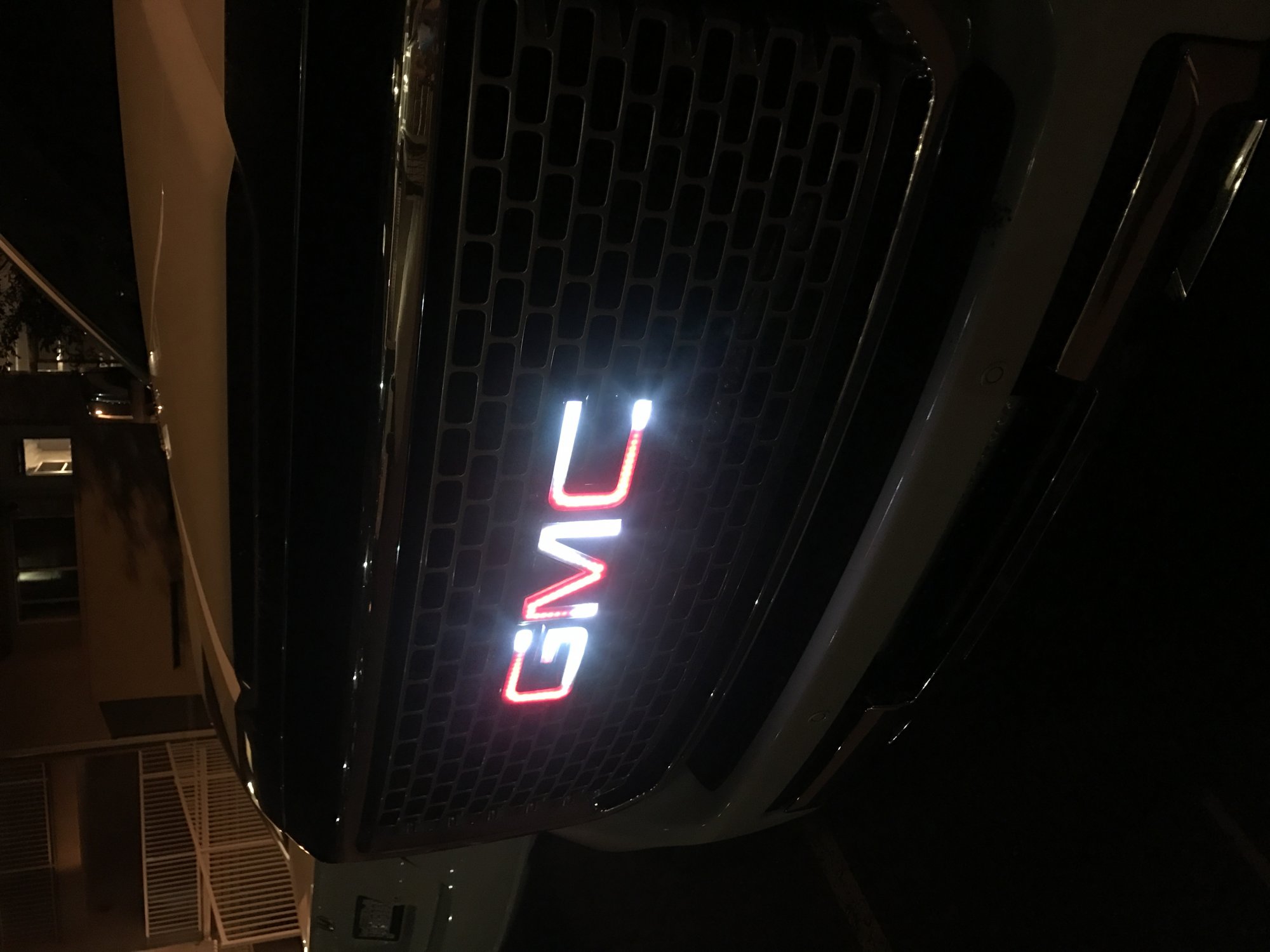

Hey just found this forum. I did kinda the same set up. It changed on an app with 200+ sequences. Can change to any color.
Where can I get one of these and how do you instal it??
It was a project on the side. Used the OEM Factory GMC emblem, cutting and epoxying it. Took lots of time but after all said and done. All I had to do was pop my GMC emblem off and pop this one into place. Made the wiring harness too, so just had to connect positive and negative.
