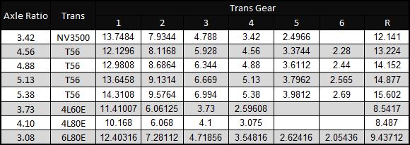

Be glad you don't have 3.08 gears like I do. I have a lot of weight in my toolbox, but as I've said on here a lot, I helped haul a love seat with a recliner on both sides and I could feel it. I wouldn't have felt it in my 98 with 3.73 gears with the same stuff in a toolbox.
That's surprising since the 6L80+3.08's has lower gearing than a 4L80+4.10's... Probably the lazy shift points with the K2 trucks.

I understand ratios, maybe it's my mind thinking it shouldn't have felt it and it did. I really don't know. I do know I want to swap them out for 3.73s or at least 3.42s. It's just a little embarrassing that my old truck with less HP and TQ but has a higher tow rating than my '14.
