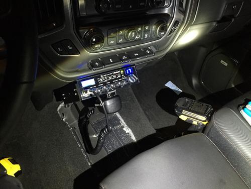

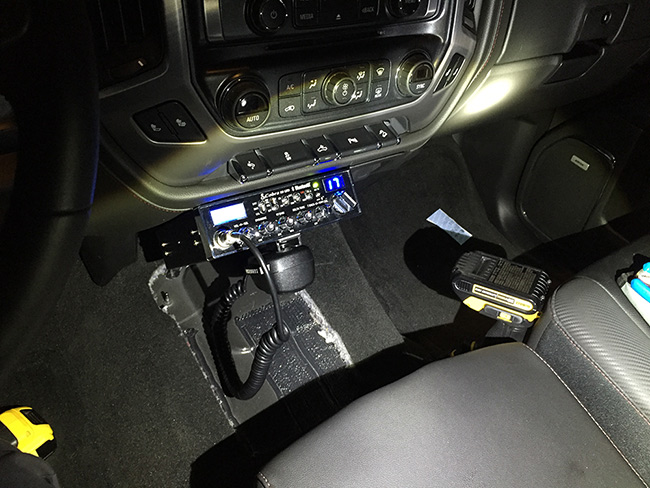

It just sits on the hump in front of the seat. I have a Re-Trax Power Pro coming and I intend to run all the power wires for both when I do that install. I also am curious on how hard it will be to drop the headliner down......any body guys out there that have done that? I don't see a down side to drilling a hole right in the middle of the roof for the antenna. Never had one to leak, easy to plug, and it won't hurt the trade in one bit.....especially if you keep one as long as I do.
good job. clean installed
Thanks, took a few new pics.

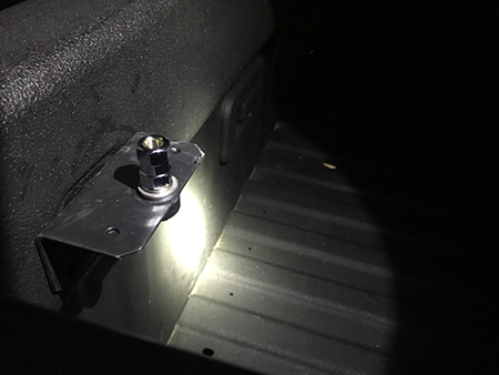

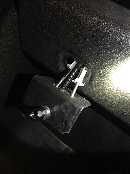

I also made a quick CB Antenna mounting bracket out of a Simpson tie (plasti dipped). This uses 2 metal anchors so no-drill needed until I figure out a permanent solution. Also routed the cable to the Radio following factory wiring paths - removed the rear seats to find a route in the cab via an existing rubber grommet.

check out www.breedlovemounts.com , stake pocket mount . EZN 4 Degree pocket bracket # 046 .
I'm going to predict your SWR will be too high.

Can you get to that grommet without removing seats?

SkippyG4- Good looking install. Have you measured your SWR's yet? If so, what are they? What about wind noise with the antenna?
1.3 - 1.7. I had the local CB shop throw the pl259 connector on and check the swr for me. They were impressed about antenna and radio clarity. As far as antenna wind noise I will know tomorrow with my 6hr round trip road trip to visit my daughter at college and to visit her Chevy Colorado named Reba!
I had the same Antenna set up on my 2013 Silverado.....no wind noise. I'm really interested in the CB ya got there.....how does it perform ??....comfortable while using....looks bulky ??
good clean installed . is that a 4 ft. antenna ? how about a quick disconnect - garage / parking ramps ?
