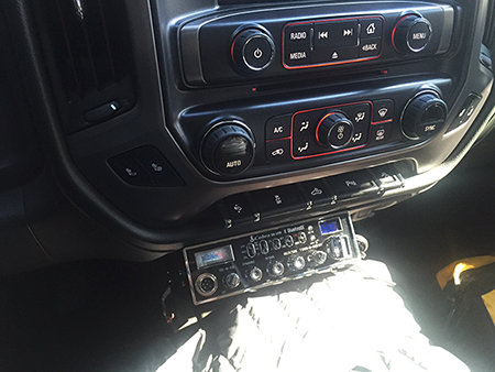

Last night I was in my driveway playing with the radio. Reception is unreal. I was hearing people from all over. I heard some skip from Virginia. Nobody could hear me.... they all had base stations and such. They were miles and miles away. I've run a lot of CB radio setups since the early 2000's and I will say that this new Cobra 29 LX radio has the best reception of any radio I've used. Hands down. Unreal tuner. I'm not a fan of the LCD display as it washes out and it's hard to see at an angle but that's my only gripe on the radio.

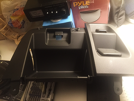

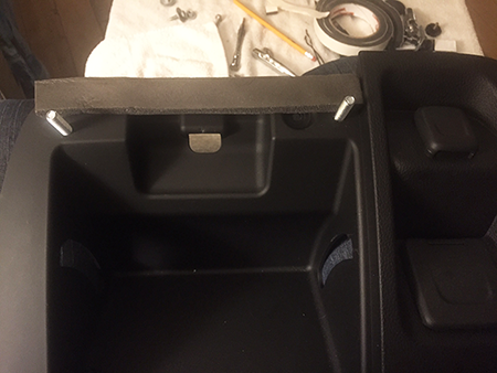

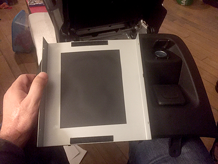

Finally figured it out.
I went the same route but removed that door (since im not using it) and mounted it directly onto the trim piece.
A Cobra 29LTD BT seems to fit right in - using 2 bolts on top to hold it.
The bottom is held by mounting to the two mount points.
I need to take better pics, but I like how flush it is this way, no bracket currently.

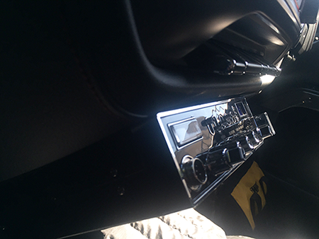

True, I previously had the console and swapped it for then imp seat. My CB was mounted inside the large storage, with the Mic cable ran under and out of the bottom of the driver side map pocket. This way the cable can store in there when not being used.

I got another decent radio check today on the way home. I will say it again, this Cobra 29 LX receive is unreal. However I am not very happy with my transmit range. I believe it has a lot to do with the 3' antenna. I can't seem to get out more than 3-4 miles. So I hear all this talk, feel like I am running a full whip on the receive. Then I go to transmit and am reminded that I have a 3' antenna. It's better at listening than transmitting for sure. I looked at antennas last night. My plan B antenna is the 4' Wilson silver-load. 1/4" diameter vs the firestik 3/8" to help with wind noise. And it's 1' taller to help with transmit range. I ran that exact Wilson for years on my 4runner and it worked very well. It's also very flexible compare to the firesticks. So off-road it was my friend. I used to wheel pretty hard core in rock quarries in N FL back in the brush. I saw jeeps flip over, axles breaking. Ah yeah... the good times. But on my 4runner crawler I either ran a full whip on the RR bumper corner or swapped it out for the 4' wilson so it only stuck over the roof like 18". Depending on what spots we wheeled I'd pick the antenna. The whip, with a Fity-wizat-bizox would get out like no tomorrow. I would talk 15-20 miles like nothing. I can see a 4' wilson in my near future. I think the 3' is geared for local chit chat and car pooling etc. Would work fine on a club off-road trip for sure, but not really a good get out and talk antenna size.

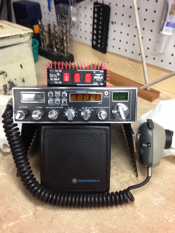

we have settled on the Midland 75-822, firestick II 3ft antenna and the bed stake mount.
When I get to it, this is my rig. Sits just perfect on the hump. I've got a Wilson 1000 mag mount and will probably drill a hole and mount it in the center of the roof at some point. First I need to run some power off the battery into the cab.
