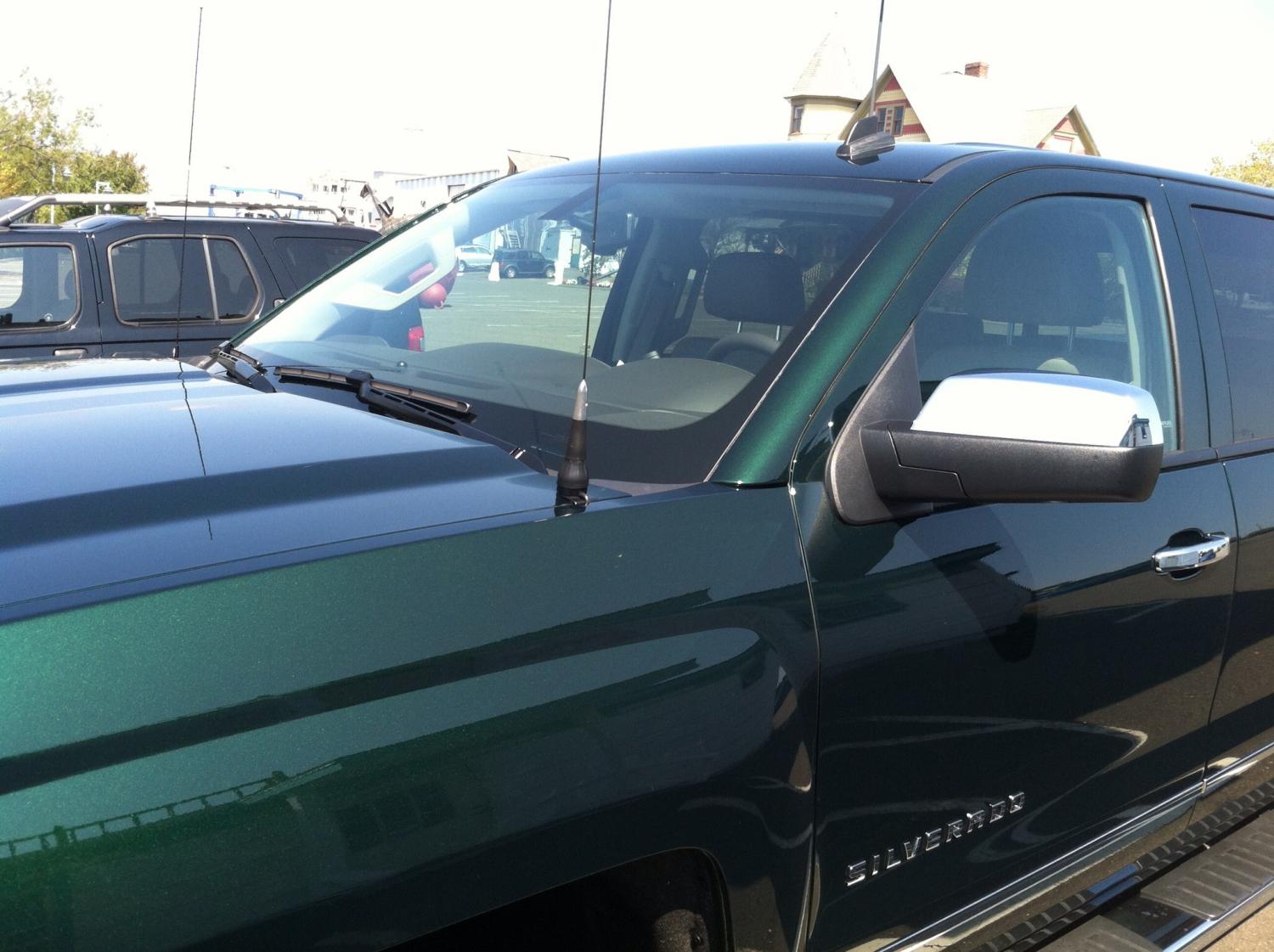

The grommet around the stock antenna is rubber and stretchy. I was able to monut the 3' firestik on a spring without modifying it

I installed my CB antenna in the stock antenna location. SWR is great! Removed the ashtray and installed the radio directly to it. Lots of radio traffic around here.

I left it attached to the wire and layed it flat under the cowl.

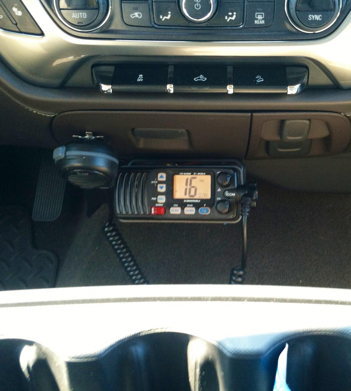

I have my antenna mounted (Thurs morning), took pictures yesterday morning after I got home from work, CB/scanner are mounted and power ran (not connected, yet), and now it's just a matter of finding a way into the cab and routing the antenna cable to my CB and then routing a antenna cable from my stereo to the scanner.
Closeup of my antenna mount
Mounted My CB Antenna

Installed My CB & Scanner
Still trying to find a way to route the cable into the cab from the bed.
look under cab rear , there are some rubber plugs in the floor under carpet . just run your cable there .
I ran my power wires thru the firewall on the driver's side. There is a big rubber grommet with a wire bundle running thru it next to the steering column. I just poked another hole in it and stuck the wires through. I haven't mounted an antenna yet. But, I'm going to drill a hole in the middle of the roof. That is where they work the best and it won't hurt the resale in the least if you plug it with the proper rubber plug. They won't even look twice at it and probably won't notice it to begin with. Besides, I'll probably keep it for 10 -15 years anyway.
Yup. I have the fender mounted antenna bracket as well for my ham radio antenna. Works great. I'm done with roof mounted antennas.
It only took one time with a magnetic roof mount. Maybe I had the wrong type of antenna on it though. I was completely new to CBs so I had a 3' fiberglass whip antenna like an 18 wheeler and it just kept flying off the roof at interstate speeds. So I don't know if the magnet wasn't strong enough or if I needed to at least add a spring. After that I just mounted an antenna to my toolbox. All that I did on my '98. I don't think I'm even going to add one to my '14. If I get an older Chevy to play in I'll put one of mine in that one, but not the '14.
