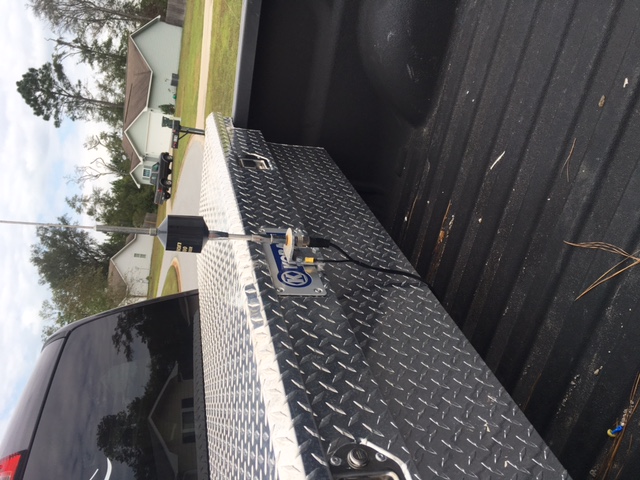

I made a mount for my bed because of my bed cover wish i haf pics, but it involed removing the bed from the truck to mount it

Mine was 1.0, gotta keep it low, i run a 98vhp
Removing the bed really isnt hard!
Its only like 4 bolts and maybe 2 wiring plugs. I had it off,drilled,installed and back in place in under 2 hours

I've never been able to get a decent SWR mounting the antenna on the toolbox.

That's cause aluminum isn't a good ground these beds have the plastic protector. But if you look at my antenna that extra wire with the yellow end is my ground wire and it runs to the frame. My SWR is .3 pretty close to perfect.
It help my coil was above the roof, plus it was mouted to the bed and not a tool box mouted to bed

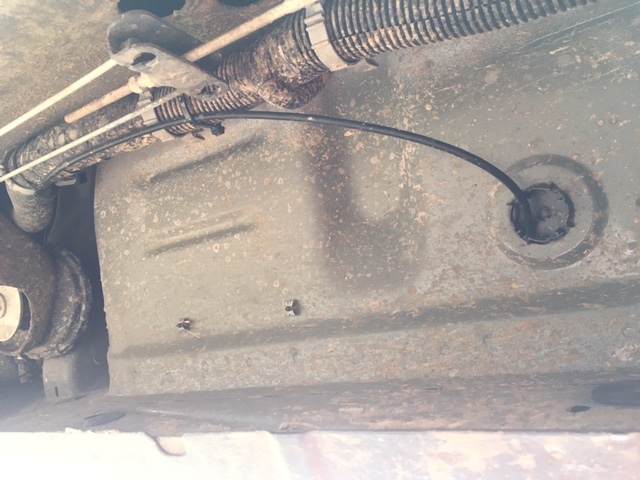

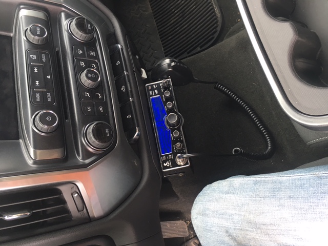

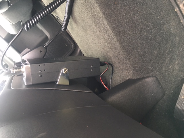

Ok. Finally months later I got some pics posted. I will take pics of the antenna today. I'm running a 3' lightweight firestik. SWR is at 2.2 according to the radio. Yes it's high. I believe I need to work on grounding the antenna better or adding a 10ga ground wire to the base in the fender. Few notes here... the Coax is running through the firewall through a spare boot would be cable. So I cut the tip off it and ran the coax through. Once everything was in place I used clear windshield silicone to seal it up well. Coax then run under the center console and comes up under the cup holder area. I drilled a hole in the console, under the cup holder area, uder the rubber pad down there for the coax to enter in a corner. Then terminated the end of the coax. When my CB is not in use, I store the coax lead under the cup holder area. you do not see anything. When in use, the coax runs through a gap between the cup holder and the console in the corner. For mounting the radio I went on Ebay and found a vendor that sells PVC/Plastic sheets. I had him custom cut. Cost me like $12 shipped to the door. It's 1/4" thick PVC sheet. 9-78" long, 3.75" Tall. I then mounted the radio's normal mounting bracket to it using some counter-sunk SST screws from HD. The PVC sheet fits into the vertical slot channels in the console. This system truly works beautifully. It takes 15 seconds to setup and take down.
