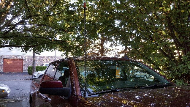

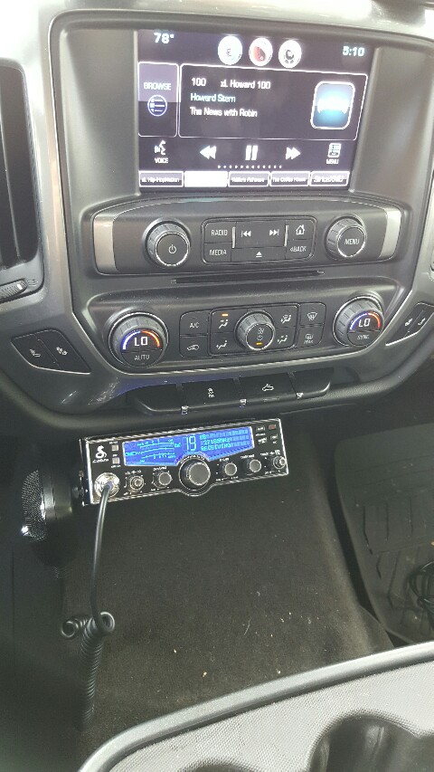

I installed my CB antenna in the stock antenna location. SWR is great! Removed the ashtray and installed the radio directly to it. Lots of radio traffic around here.
