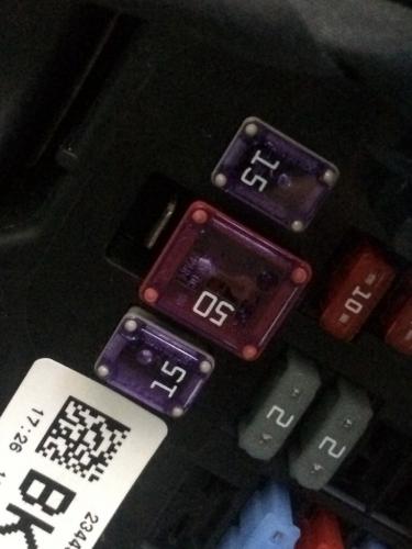

Pull the fuse cover off of the left side of the dash (takes some effort). Consult your owner's manual for specifics on which fuse to move to change the operation from Always On to On With Key.

Fuses are behind the cover on the left side of the dash. Information on which fuses are for which outlets is in your user manual.
The fuse is located on the drivers side fuse panel inside the truck. The fuse is a red 50 amp fuse. If you look at the fuse you can see that there is a terminal beside the fuse not connected to anything in the same fuse spot. Just pull the fuse out and move it so it uses the terminal that wasnt being used. This is an aweome feature.

I moved the fuse as stated above and nothing happened with the 110v outlet or the others.......
This only changes the 12 volt outlets not the 110 outlet.
I tried the USB and both 12v "cigarette" lighter locations and got nothing. I will try again tomorrow.
When the 50A fuse bridges the center terminal and the terminal toward the front of the truck, the 12V outlet on the dash only has power with the key. When it bridges the center terminal and the terminal toward the rear of the truck, it has power all the time. No other outlets are affected by this fuse.
