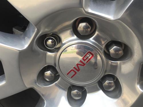

Does anyone know the GM part number for these wheel locks? It looks like there are at least three GM part numbers for wheel locks, and I'd like to get the set that looks closest to the factory lug nuts on my wheels.

Thanks Jeremy. On the GM truck accessory website they also list part number 17802466. There are some good reviews on Amazon for this part, but the wheel lock is 49.9 mm long, almost 2 inches. The Gorilla wheel locks in 2plus2's photo are 1.5", and look about the right length, so I'm guessing the 17802466 wheel locks are probably a little tall and would stick out too far. I don't want to over think this, so might just save some money and get the Gorilla wheel locks.
The two numbers I listed are described as non-decorative, the number you found is described as decorative but that's ultimately the only difference. Even the "non-decorative" ones will look fine though.
Edit: just looked at the 12498076 umber in my stock... they're ugly, go with the decorative ones, I looked at them too and they're a lot nicer. lol

I ordered the Gorilla locks (61641) from amazon. They look great.
