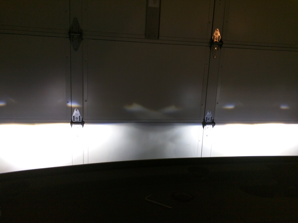

So I have went through different configuration of different type of aftermarket bulbs, 35w HIDs, 55w HIDs annnnnnd!!! 45w (4500lm) LEDs.
Here is the comparison shots
Left: LED Right: LED (dont worry about the bright dots on top of the cutoff, I have managed to fix them)
Left: LED Right: Stock Halogen
Left: LED Right: 55w HID (DDM)
Left: LED Right: 55w HID (DDM) in high beam

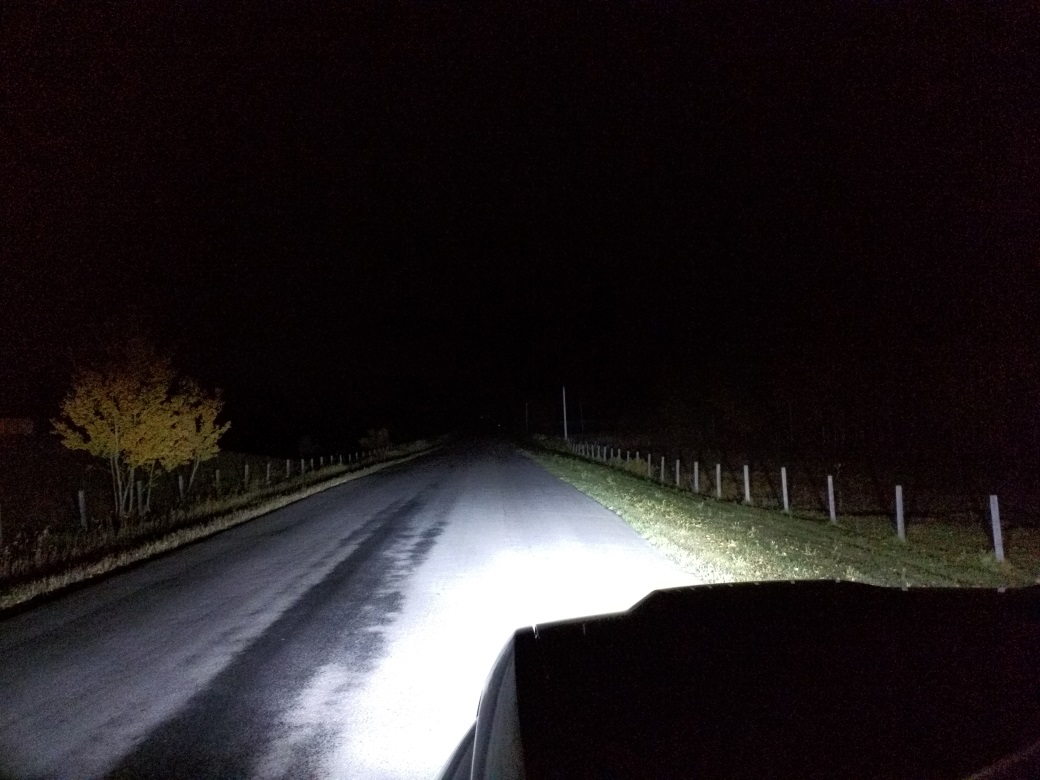

Here is a shot of the brightness of my current setup - highbeam with fogs on:

The pictures does not show, but in high beam, HID has a bright spot at the top when shutter is open for high beam, this actually makes high beam pretty effective. Even in low beam, the light of the HID gets brighter towards the middle, the LEDs have a way more even spread of the light over all. LED's high beam just opens a top portion with a nice smooth even light, not as effective, but has a smooth output when in low beam, I kind of like that.
I hope this thread helps you compare the different types of bulbs. I have taken a lot of time to adjust my LED bulbs to get the sharpest cutoff and with the smoothest beam pattern.
Please add your results too!! I'd love to see what other bulbs you have tried!

I have my 4500lm fogs to come on when i use high beam, so everything still lights up like day light

You are right, highbeam is a little disappointing, but my fogs more than makes up for them now
What fogs are you running? I'm using the XD 5202 30W Cree fogs. I can actually see a little extra light out to the side when I turn them on.
Same as the ones in my headlight :smoker:
18000 lumen in total without any light bars.
My fogs lights up everywhere my main headlight doesnt.
As a matter of fact, I just played around with my offset more, my highbeam is way better now. Cant wait to try it tonight!!
