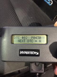

Beatme Posted October 11, 2015 Share Posted October 11, 2015 Hey all, just installed my kooks and catted y pipe on my blackbear tuned 2015 5.3 and had a question/concern. Now I know I'm gonna need a retune and will do that as soon as I get my autocal back from my buddy, but it's throwing codes P0420 and P0430. Is that to be expected? Truck has airaid MIT and stock catback, sounds pretty good and seems to run good to, can't wait for the retune! Link to comment Share on other sites More sharing options...

bigsapper Posted October 11, 2015 Share Posted October 11, 2015 Yes that's expected. Give Justin the codes and he'll turn them off. Link to comment Share on other sites More sharing options...
iCryWheniGoPoop Posted October 12, 2015 Share Posted October 12, 2015 I'd bet you got the Highflow cat option. This will trigger the CAT efficiency monitoring (since they don't work as well EPA wise). No worries, like said before its normal and tune will fix) Sent from Off Driller Side Link to comment Share on other sites More sharing options...
RobZ71LM7 Posted October 12, 2015 Share Posted October 12, 2015 Yup, normal. You just need a retune. Link to comment Share on other sites More sharing options...
TJay74 Posted October 12, 2015 Share Posted October 12, 2015 Both of those codes are for the post cat (after cat) O2 sensors, as said they are reporting that the cats are not operating at the correct efficiency. Justin will turn them off in the tune as they are not used for fueling control, only to let the customer know if the cats are working correctly. Link to comment Share on other sites More sharing options...

TJay74 Posted November 26, 2015 Share Posted November 26, 2015 Those are normal, catalyst below efficiency error codes. Turn them off in the tune and you will be good. Link to comment Share on other sites More sharing options...
