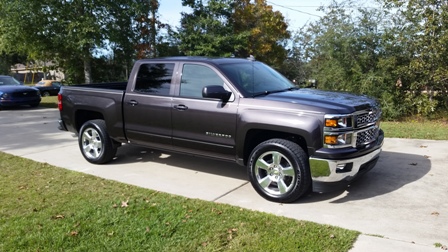

Greetings all,
Today I became the new owner of a 2015 Silverado LT All Star Edition. Very impressed so far. This is my first Chevy truck and hope all goes well. Traded in my F-150 with 203K miles on it. So hope to own this one till the wheels fall off. Then repair and keep on going.
Greetings all,
welcome! Awesome truck congrats. Its good to see a fellow all-star!
