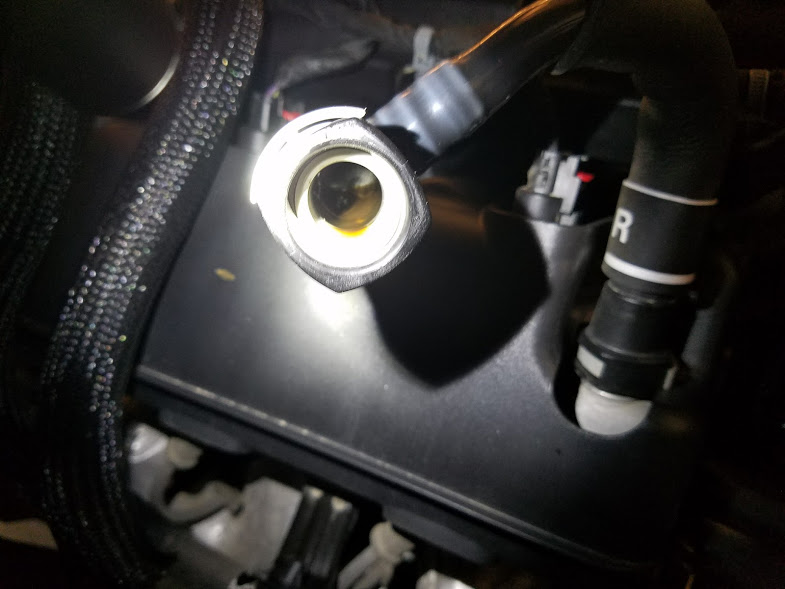

Thanks Joe. Not the case here. No cracks or leaks at all in my system. The problem for me was that the hoses my can came with were NOT vapor hoses. My Camaro RX can came with all Vapor barrier hoses and it's never smelled. My firend also has a can on his turbo Kia and had the same odor. We swapped my Elite and his can over to Gates' vapor hoses and now...NO MORE SMELL! Elite should really be shipping their cans with vapor barrier hoses. I can STILL smell the outside of the hose and smell fuel/oil.

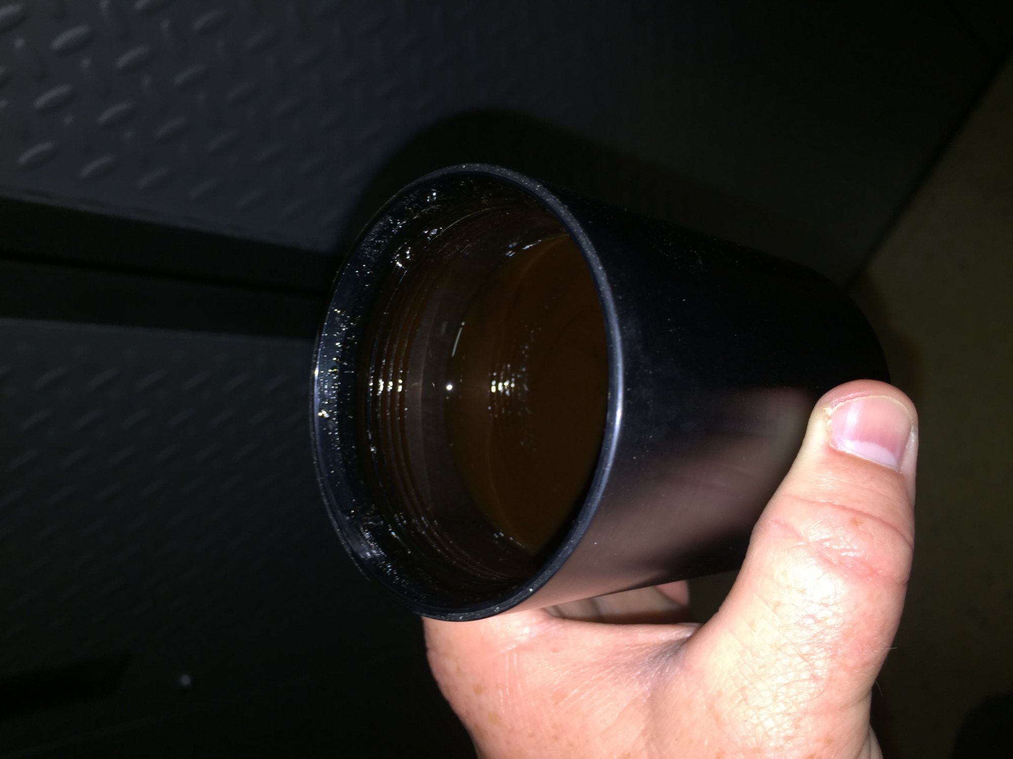

I ended up buying a UPR plug and play catch can. Went with UPR since it came with hoses and factory fittings. It made a loud whine for the first hundred miles but now it's quiet. I can't open it up to see what's inside but however it's made it seems to work. The picture below is after ~1,200 miles. It is a thick oil sludge and I'm glad it didn't go into my intake. It's roughly 2oz.
I hope this picture works, it was a pain to reduce to the correct size.

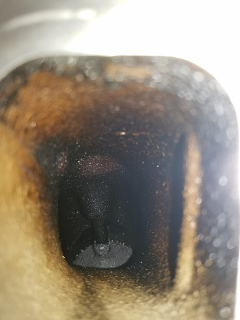

Decided after reading through this and a couple other threads on the topic to do a little investigating on my truck. I havent owned it that long, about 2 months. I noticed that it didnt seem to start as easily as it should.
I had some time so I tore the intake off yesterday, and found a mess. Well first I would like to punch the designer that fastened the wiring to the intake with those stupid push clips, seriously, especially the big ones on the back of the cover. If you take your intake off, take the 4 bolts holding the cover out and slide the intake under the cover to remove it, then you have enough room to manipulate the top cover and get the clips out of the back.
I was probably going to add a catch can to the dirty side, after tearing into it I think Ill add a clean side separator as well.
Here is what mine looked like, 2014, 5.3, 40000 miles.

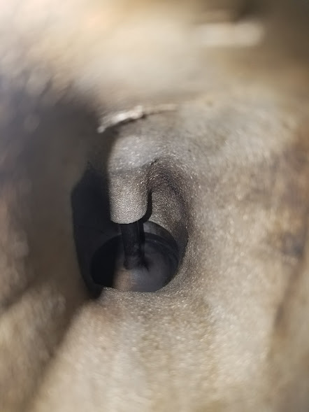

Much Better...
Guessing this is after picture, how did you clean yours?
Mine was without a catch can until 44k miles so Im assuming mine will look similar.
Yes thats after, kind of hard to get decent picture.
I would say I got about 90% of it off, what I did first was to figure out which valves were open, in my case 2 and 7 were open, the other 6 were closed. So I worked on the other 6 first, I used some Seafoam to soak them. While that was in there I used the combination of a tooth brush, parts washer brush, and a 410 shotgun bore brush bent at an angle to try and brush the valve. After that sat for a while I sucked it out with a baster into a container. The baster worked ok, but not as I had hoped, a better suction tool would be alot better, maybe the aggressive chemicals ruined it. Alot of paper towels were needed to keep the mess off of the injectors and wiring as the baster wouldn't hold suction.
After all that was out I switched over to carb cleaner and did the same process, while also focusing on the walls of the port. On the first 6 I let this sit in the port and soak over night, I didnt need the truck so figured it wouldnt hurt, and it didnt, these 6 valves came out better than my other two with less work.
After letting those sit over night I sucked all that out, and rinsed one final time with carb clean. Sucked that out, and then shoved a paper towel down into the very bottom of the port to soak up what I couldn't suck out. After that I blew compressed air into the port to blow out any debris.
Then I re taped those ports to keep debris out of them, rotated the engine by hand until the other 2 valves were closed and did basically the same to them, with the exception of not letting them soak as long
With all that done I took the truck out for a drive and can notice a difference, it starts better, idles better and just overall drives better.

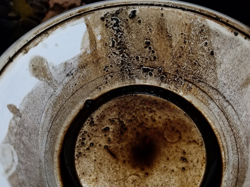

Hi all. Just wanted to share my experience thus far. I have a 2015 Silverado with the 5.3l and 46k miles. I installed an Elite catch can 2,500 miles ago and figured I'd check it last night since I normally change the oil every 5k miles and was told that's the best time to empty it. I couldn't believe how much it caught in so little time. Guess I'm going to need to check it every 1,500-2,000 miles.
So we're draining a cup of 'oil' from these cans every thousand miles or so and yet we are not showing a loss on the dipstick?
That's a neat trick.  If you're old enough to have worked on motors with draft tubes and carburetors you still saw intake runners fouled if you given them enough miles. Sooner if worked hard.
