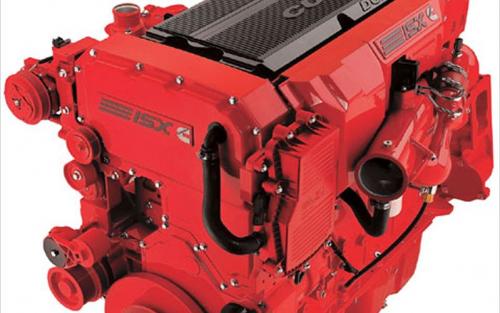

Actually, I take a different approach. I find it interesting that the commercial heavy engine OEM's did feel the need for CCV oil filtration, or "catch cans", on their motors. GM is really behind the curve as opposed to in front of it. Vehicle assembly is all about cost as much as quality. If GM can save $1 in vehicle assembly, they can save millions of dollars. A catch can wouldn't even be considered.
But all the heavy duty engine OEM's think it is worth it. This a a Cummins ISX. One can see the black hose from the front of the motor going into a box on the side. That is the oil filtration "catch can". The black hose behind that can be seen going on to the intake tube.

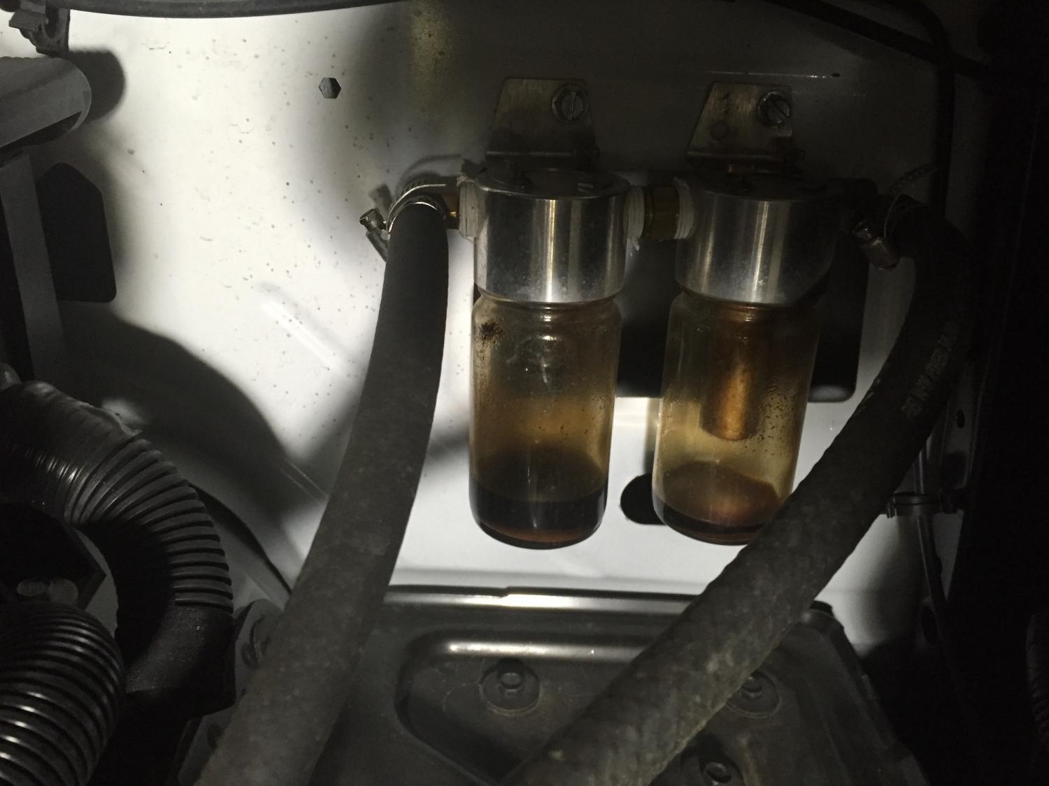

And here is a recent pic I took of the catch can setup on my 2015 2500 6.0L. Not nearly as bad as my previous 1500 5.3L, but I feel better not having that glop going to my intake. Not the greatest pic, so it is hard to tell that there is actually about 3 oz of oil and such in the catch can. The first gets the lion's share, and the second gets what the first missed.
Even if one to worry about warranty issues having a catch can on (I don't), it is an easy deal to disconnect and restore to factory before going to dealer. I can have my catch can disconnected and PCV line restored to factory in about a couple of minutes.
