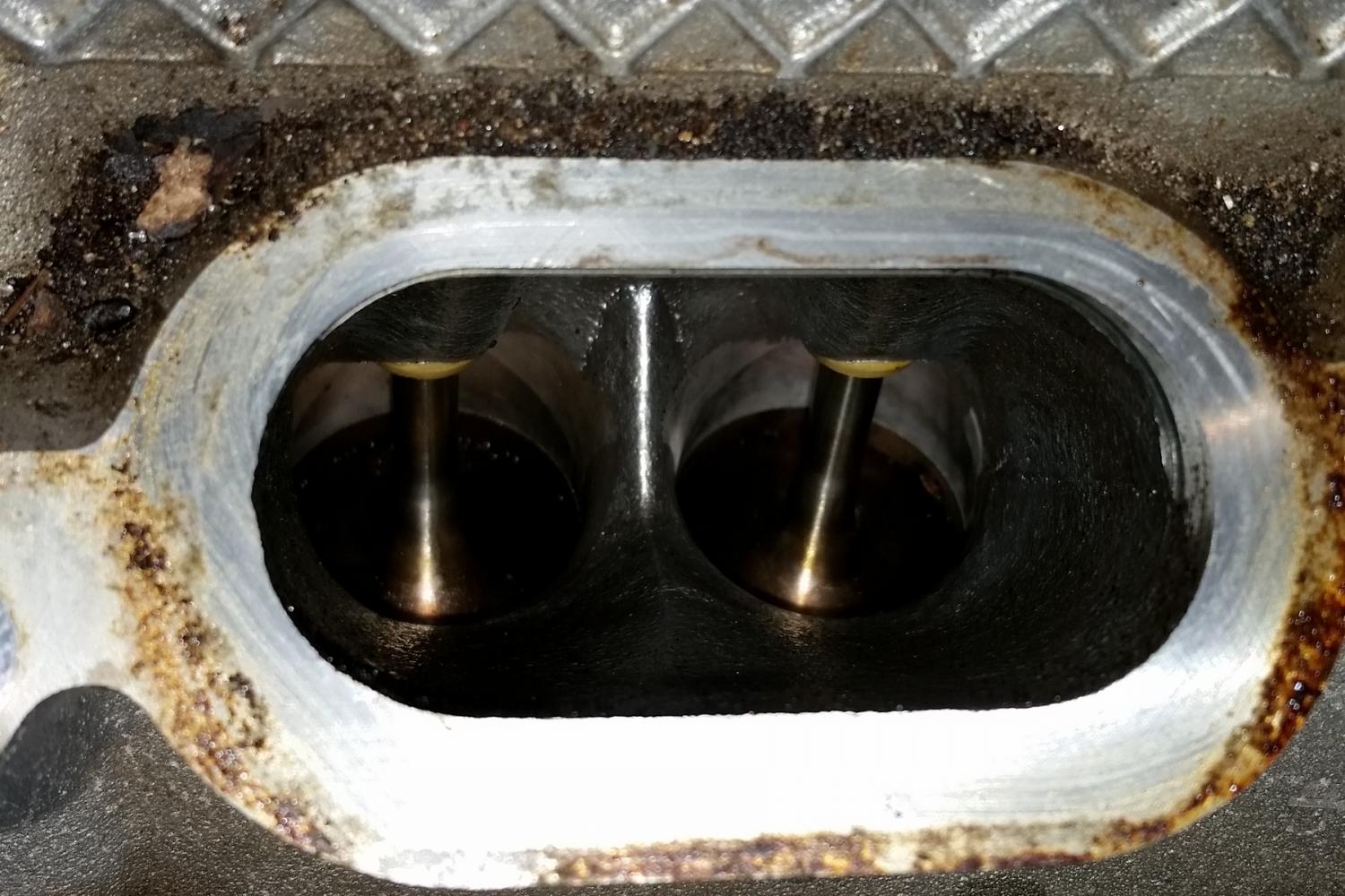

Here is a picture of my wife's Acadia with 30k on it. I cleaned the valves manually (yesterday) before putting on an Elite E2-X can. I can tell a difference in acceleration. I also installed an E2-X on my truck (had the standard can but decided to upgrade to the E2-X since it performs better with GDI engines).
Pretty crazy buildup if you ask me. i recommend manual cleaning after seeing this (after 15-30k without a catch can). The cleans just push this into your engine and it can't be good for it in the long run.

I basically just took off the manifold and cleaned the valves with a copper brushes (used a gun cleaning kit). It took about 3 hours start to finish and I would say I'm handy and somewhat mechanically knowledgable...not hard once you get into it. Need to make sure the valves are closed all the way and tape off the others openings where the valves are open. I used compressed air to blow it out and get everything out. After cleaning most of the build up off I used CRC intake valve cleaner, let it set in and cleaned them again with the brush. There is a lot more to it but a member 'GDI Tech' helped me with directions. PM me if you want them. They were for my Acadia but should be simular to our trucks method wise.

My only concentrate with using Seafoam at that mileage is you're pushing all that buildup past the pistons and scoring the cylinder walls. Might not be enough to do anything but I'd rather not have that as a concern. It took about 3 hours for me to clean the Acadia's valves and think it would take about that on our trucks.

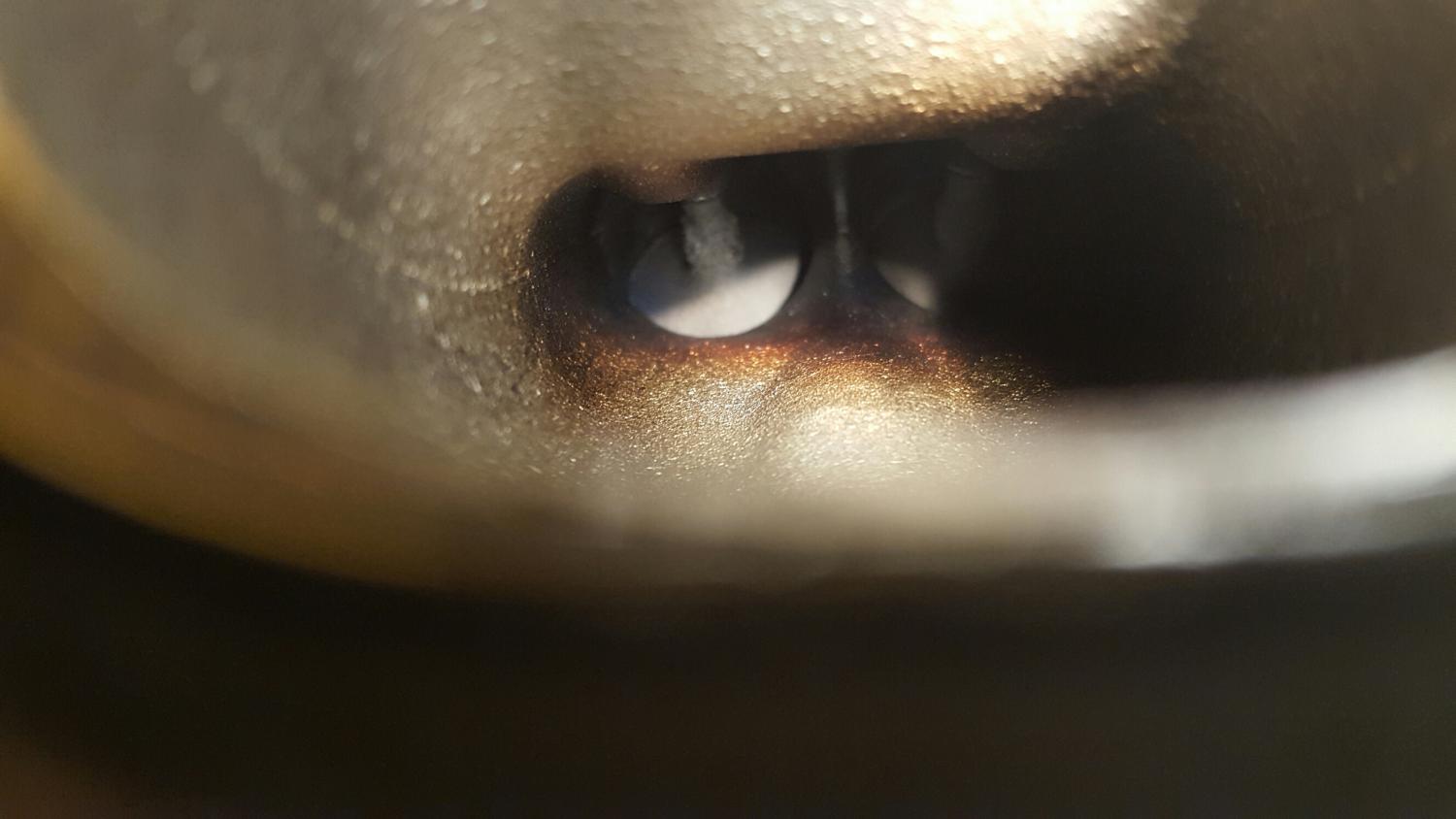

Here's an example of what the intake valves look like on a plain old port injected engine after 94,000 miles and 16 years. It's a 4.4L BMW V8.
