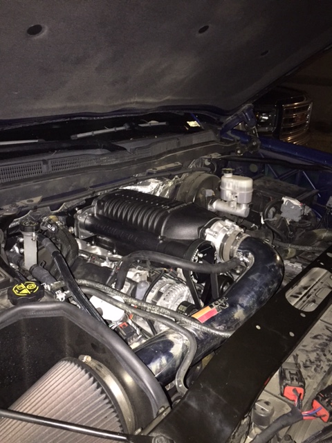

Sup guys, I just finished my whipple install on my 2014 (except the sparkplugs). It started up but it idles really rough and dies. I loaded my start up tune from black bear. Could it be the fact that i havent swapped the plugs making this isuue. Im going to swap them in the morning. geres a teaser pic.

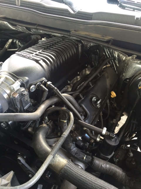

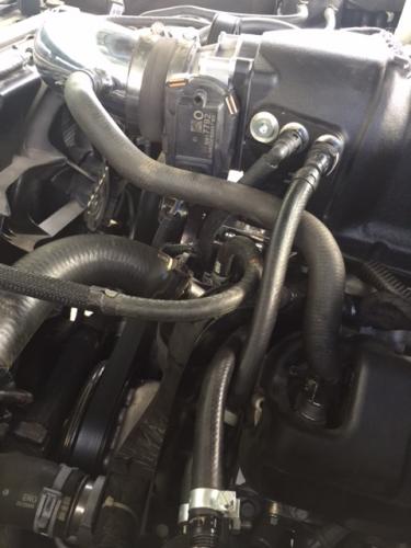

im going to swap the plugs in a bit. here some pics of the vac lines, does anyone see anything hooked up wrong?
