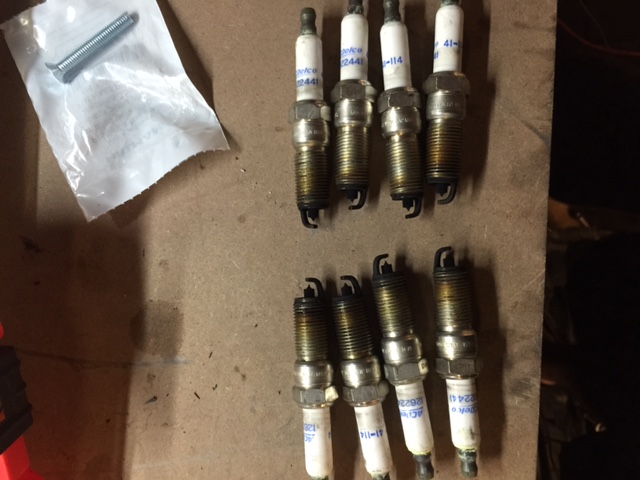

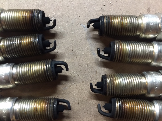

Either way you need to pull the plugs and look at them. Lean + blower spells disaster. But man, I find it crazy you guys are able to run supercharger on an 11+ compression motor. I used to run a Littlefield 8-71 with Enderle or Crower mechanical fuel injection on methanol on my 72 Stingray and I was a nervous wreck with anything over 7.5 or 8 to one.

did the spark-plug swap and changed the k&n cai back to the stock airbox and put the supplied whipple intake tube and its still the same if not worse. the truck is smoking a mixture of black and gray smoke, i can smell fuel when it starts. i notice theres a lot of condensation water build up at the exhaust.
Well I returned the tune to stock and it works perfect. Maybe my tune from black bear must really be off.
