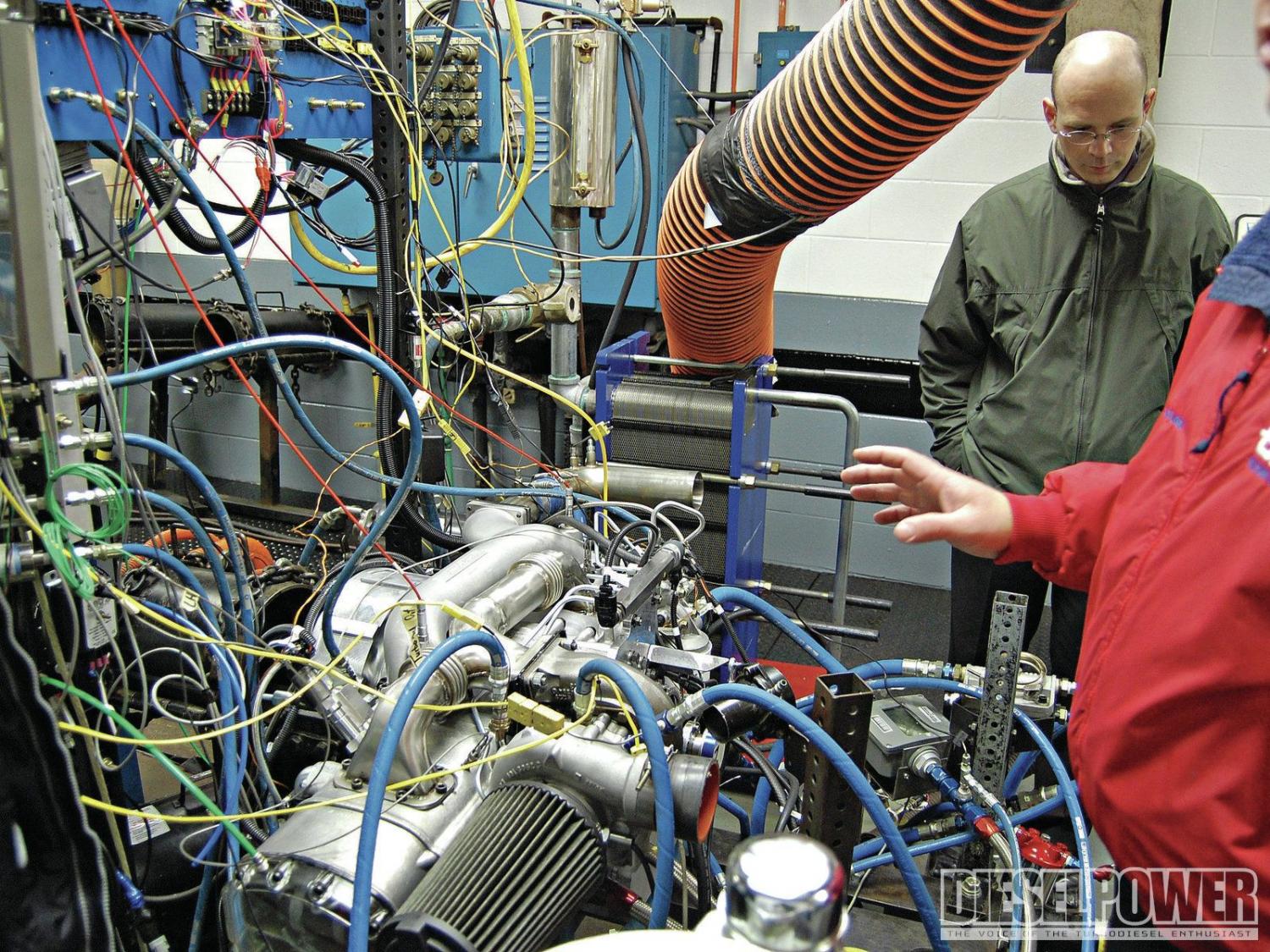

opposed piston opposed cylinder (OPOC) engine
Opposed Piston video ...
cool stuff
...A two cycle four cycle engine??? Heck they may as well eliminate the spark plug seeing as the pistons approach each other and make it a compression ignition two stroke engine. Its definitely running (per that first video) intake and compression in one stroke, then power and exhaust in the other stroke, except that there are two pistons in one cylinder, and one piston does intake, one does exhaust, and both are meeting for the combustion/power segments.
  • Replies 270
What valve timing? The OPOC doesn't use valves or any similar associated stuff like a typical inline or V engine. It is similar to two stroke design. Did you even see the video or look up anything about the OPOC before commenting? The horizontally opposed engines like the Subaru boxer don't have the oil issues you describe. Turning the corner and filling one cylinder with oil while starving another? What, you think that the cylinders are splash fed oil instead of oil pump? And why would pistons "slap" in this design worse than anything else?
And the "proven" V8.... let's look at that one. V8 diesels were tried in heavy commercial trucks in the past. Not a single HD commercial V8 diesel can be found anymore except as a collector engine. Not one OEM is producing a V8 commercial HD diesel larger than the little pickup diesels. All are inlines. So I guess the V8 wasn't so proven. Sure, there are smaller V8 diesels, but the designs are such that the OPOC could easily compete.
The V8 diesel is apples to pears, we are talking consumer level gasoline powertrains. Commercial/Industrial applications do favor the inline engines and always will.
So if this concept is so good, build one and run it through all the durability and required emission testing and see how it stands up?
I would think any OEM would jump on something more efficient, cheaper, and more powerful, it should sell itself I would think...
Eco motors already has done all the heavy lifting... Gas, diesel, NG, propane varieties. Now a matter of getting OEM's to get the Amish horse blinders off and bring out some models.
