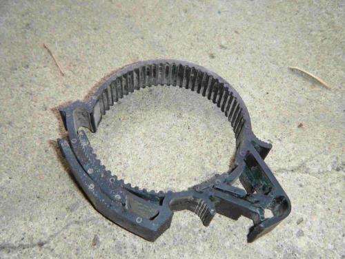

3. First thing you need to do is remove the axle-diameter sized plastic clip that holds the brake line on the passenger side next to the differential. If you remove this band it is easy to align the bar so it is evenly positioned. I could not get it lose so I used side cutters to careful free the brake line.

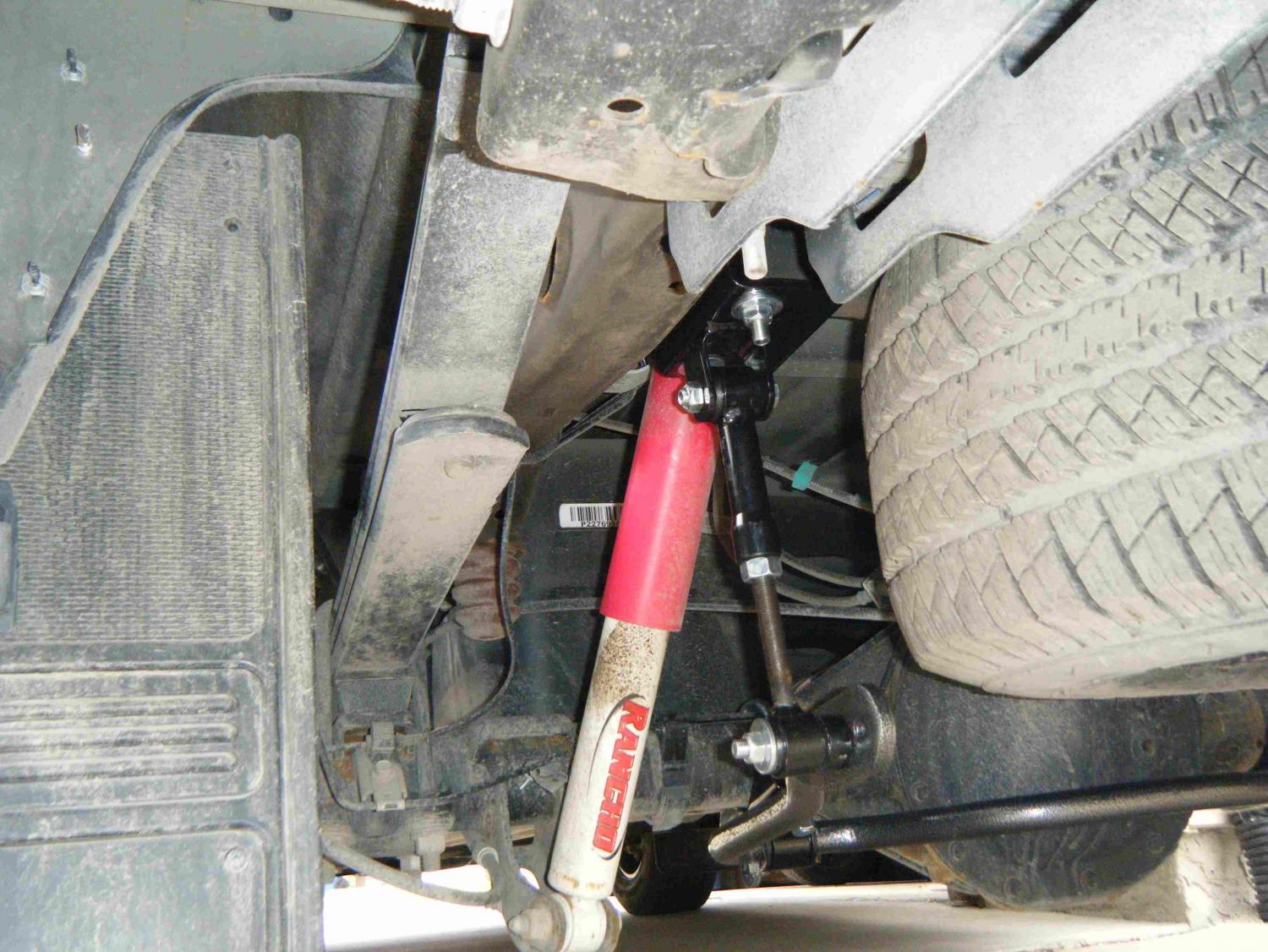

5. I pre-assembled the end-links including attaching the upper clevis brackets. If you do this, it makes the end-link assemblies easier to install and you won't have problems with torquing the clevis/end-link bolt after it is installed. Remember to use a little of the the supplied lubricant within each end-link loop before pressing/hammering in the hourglass bushings. This allows them to be inserted easier and allows the end-link to move more freely after assembly.

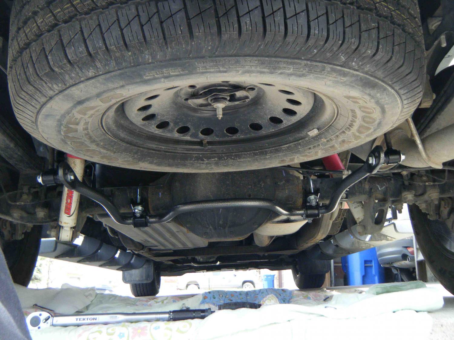

7. Attaching the sway bar to the axle can be awkward if you only have two hands. I did mine on the driveway so I used some wood to prop up the sway bar so I could easily connect the bar at the point where the D-shaped poly-bushings attach to the axle and the saddle brackets. Make sure you lube the D-shaped poly-bushings well where they clamp around the sway bar. You don't want any squeaks.
8. I attached the end-links to the center hole of the three holes on the sway bar end. Because my sway bar was perfectly centered over the differential I had to use the longer bolts and the spacers, one on each end-link.
9. I had no trouble torquing all the supplied hardware to 35 ft lbs.

Here are are pics of the end-links and sway bar installed.
