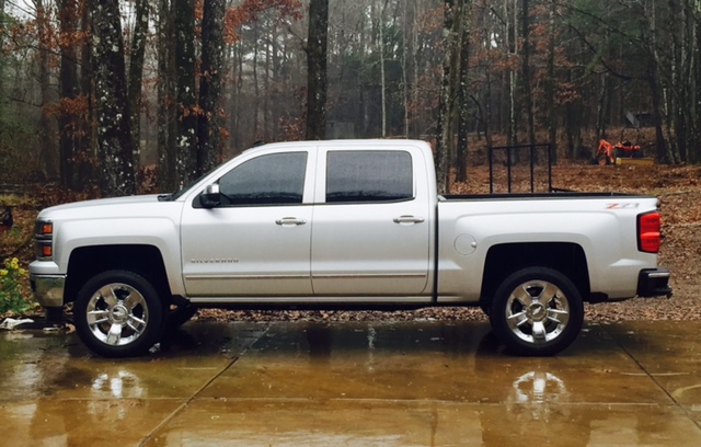

I have the RC 2 inch level front only on my Z71 with 275/60/20 with NO rub whatsoever at full lock, stock I had a slight rub in reverse full lock. I was concerned about being nose high but the RC level is exactly what I wanted .
before level
RC 2 inch
