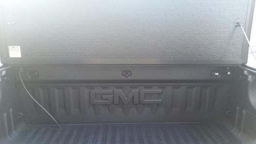

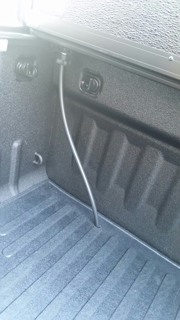

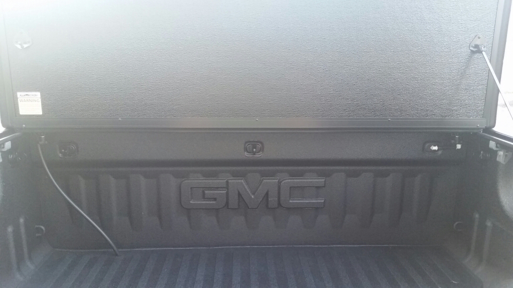

Here's both drain tubes and a closer look at the left side one which is the one that fits through the bed with no drilling.
I have a bed mat so I cut a hole so it fits through the mat and the bed.

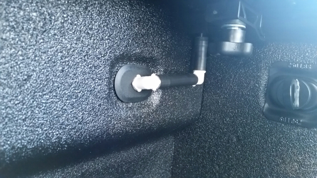

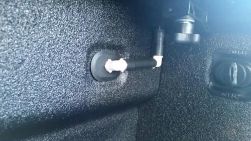

And here the right side tube.
The hole in the bed in this one isn't large enough, and I did not want to drill it bigger.
I bought three pvc 90s and cut the hose into 4 sections.

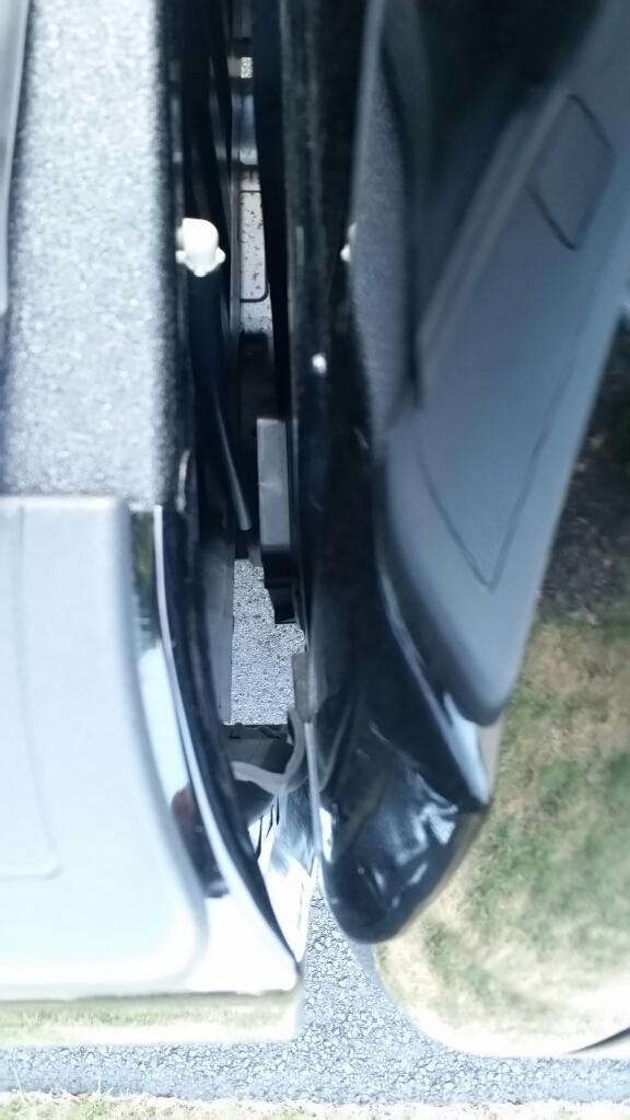

It goes down, left, right, and down again between the bed and cab.
The second picture is directly from above looking down.
I drilled a hole in the anchor cap just big enough for the tube.
