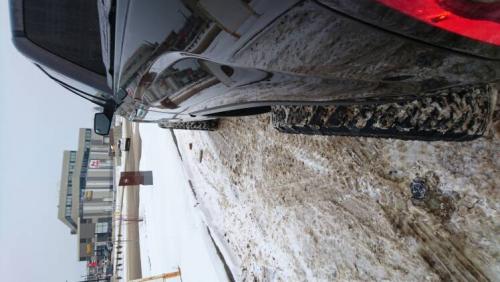

I've used 1.75 inch bora spacers on my last 2 trucks in the rear. I use loctite and torque to spec and they never came loose. Here's a pic post-146784-14568172711_thumb.jpg
