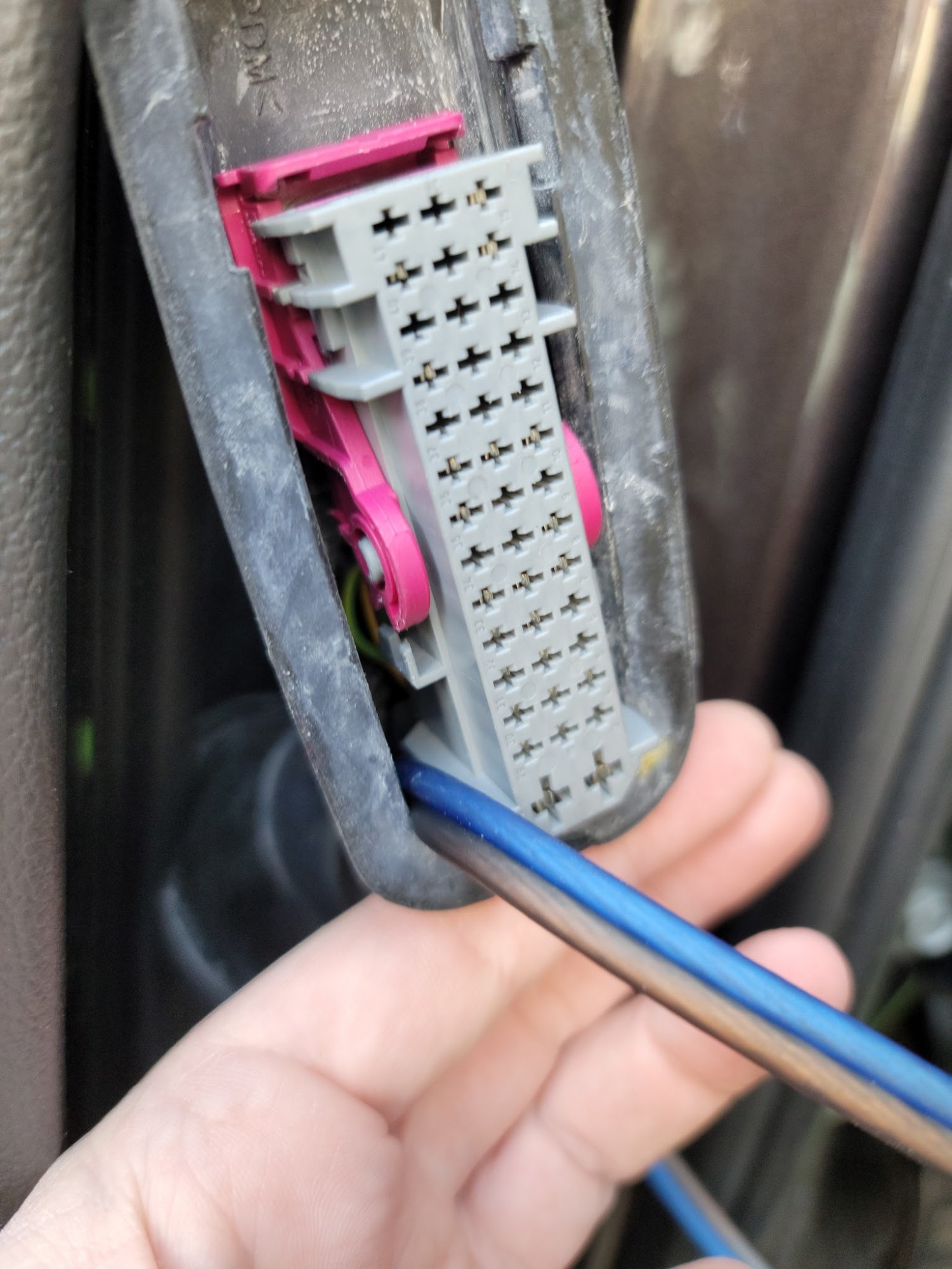

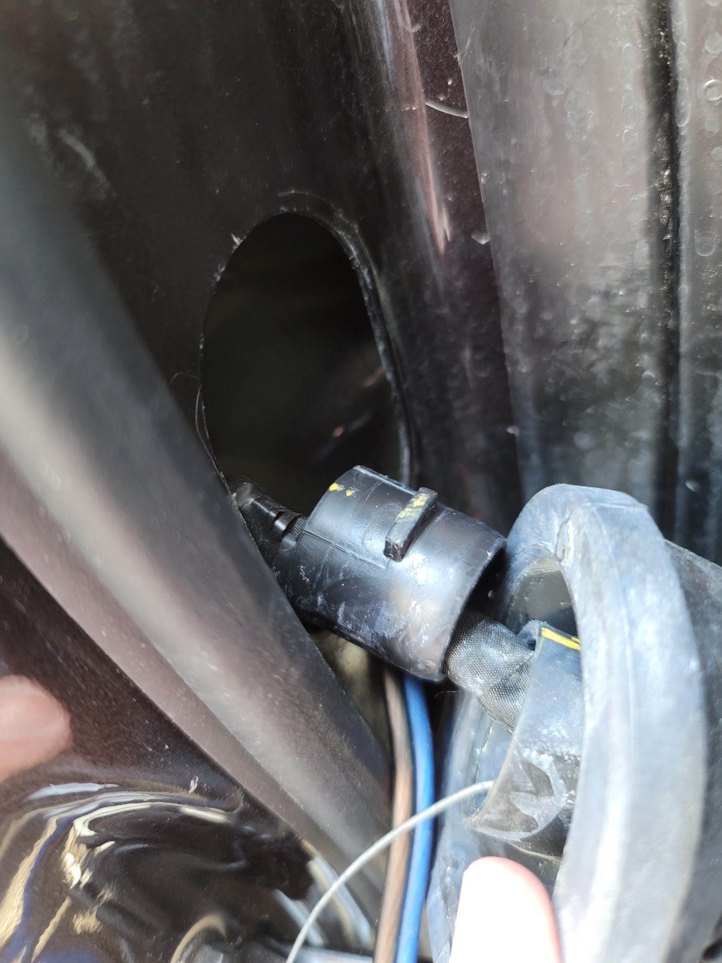

Hey all...I know this is an old one but I am doing this right now so I made a quick video of what I am doing to run the wire. Hopefully it helps. It wasn't nearly as bad as I thought. Getting the boots back on is the hardest part. At least for me. I did my back doors the same way and doing my passenger side once this side is back together.
Fyi...for the passenger side you'll want to remove the lower half of the glove box to make feeding the wire in from the door easier.

The boot is a 2 piece system where it meets the cab. There's the boot which is wrapped around a plastic retainer with a clip at the top. If you pull the boot back a little you can use a flat head screw driver to push down on that clip and the boot will pop off. No need to access anything from the inside. You can then access the pink lever clip that pulls down and unclips the harness. Then just pull the door side of the boot out, run your guide wire through the boot, attach to speaker wire and pull through. I run my speaker wire down the bottom of the boot because there is just enough room to go through the cab between the clip finger and the harness. If you run it through the top it makes the upper clip hard to get back in (or out).
