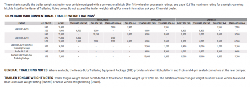

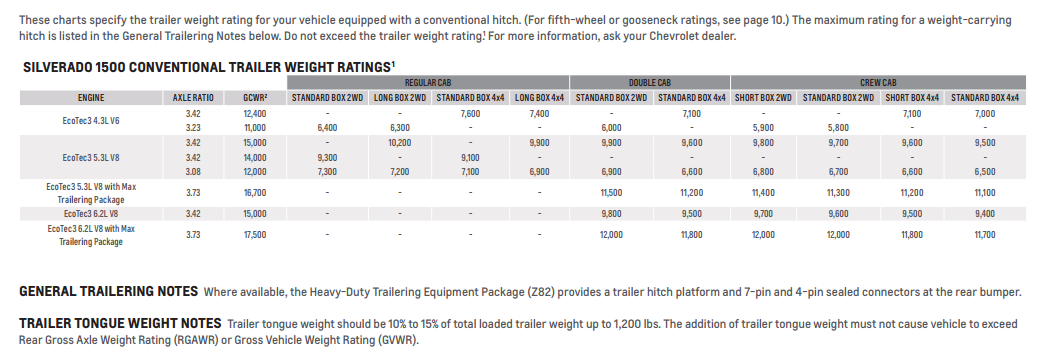

3.08 rear end will tow fine for lower trailer weights. You'll give up some fuel economy, but should have NO issue towing anything up to about 4000lbs or even a bit more. As you get closer to the max tow limit for your truck, it will work harder and harder to maintain speed, climb hills, accelerate, etc. The larger gears will help you when you tow to drag heavier trailers, but you're going to sacrifice fuel economy when you aren't towing.
I would suggest that you try to get a really solid feel of what kind of weight you'll be towing before you worry about how well it will tow and whether you need to consider changing out the gears.

Your specific truck will have its max rating for GVWR, GTWR, and GCWR on a label in the door frame. Those numbers are based 100% on the build for your truck, including the gear ratios. If what you're intending to tow is within all of those ratings, you're good to go.
Be advised that if you end up wanting to tow a trailer that EXCEEDS those numbers, you can make changes like you suggested for the gears, but your truck will NEVER be able to be certified to tow those heavier weights according to DOT / GM.
There is a GVWR sticker and a Payload/tire sticker. GTWR and GCWR numbers do not appear on any sticker on any part of the vehicle. If somebody wanted to hassle him they'd need to look in the owners manual....
