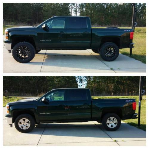

15greenz71 Posted April 9, 2016 Posted April 9, 2016 I just got a 4 inch bds lift with 35s. I bought the hypertech speedometer calibrator off amazon for $200. Dealer wouldn't do it for me. Sent from my VS980 4G using Tapatalk

tbarn Posted April 9, 2016 Posted April 9, 2016 I just got a 4 inch bds lift with 35s. I bought the hypertech speedometer calibrator off amazon for $200. Dealer wouldn't do it for me.2016-03-29_20.21.00.jpg Sent from my VS980 4G using Tapatalk Dealer Can't do it for you. At least not through normal means.
markrauenzahn Posted April 10, 2016 Posted April 10, 2016 I just got a 4 inch bds lift with 35s. I bought the hypertech speedometer calibrator off amazon for $200. Dealer wouldn't do it for me.2016-03-29_20.21.00.jpg Sent from my VS980 4G using Tapatalk Nice looking truck! Did u do it yourself? How is ride quality compared to stock? MPG? Sent from my SM-N910V using Tapatalk
15greenz71 Posted April 10, 2016 Posted April 10, 2016 Nice looking truck! Did u do it yourself? How is ride quality compared to stock? MPG? Sent from my SM-N910V using Tapatalk I did not install the lift myself, but I did recalibrate the speedo myself. The ride quality is better than stock and I'm getting 18 mpg highway, while I was getting 21 mpg stock. I've got 3.08 gears too. Sent from my VS980 4G using Tapatalk
