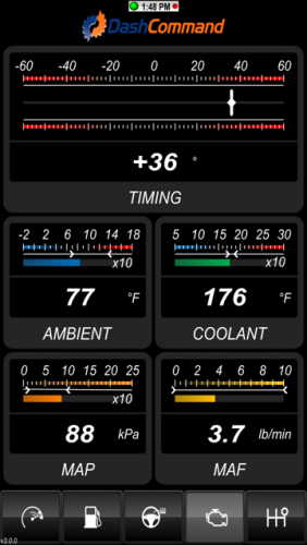

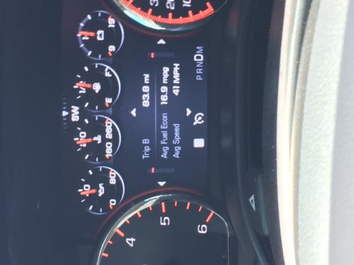

I installed a 170 thermostat and although the obd data shows 17x the temp gauge is way closer to the 210 mark.
My gut it telling me to go off of sensor data over a gauge but still that's a pretty substantial error.

Yes, it's programed to read exactly 210° pretty much all the time so owners won't freak out and go to the dealer when the engine warms up a bit. It'll only show a tic below 210° even with the engine pretty darn cool. The one on my Denali reads exactly 210° from about 187 to 225 degrees. So once it creeps above 210° on the gauge you're pretty toasty....
