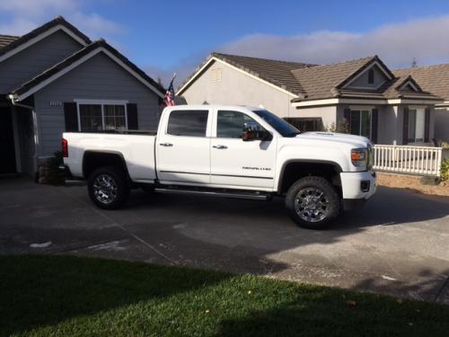

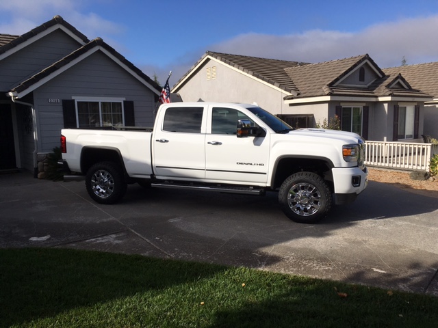

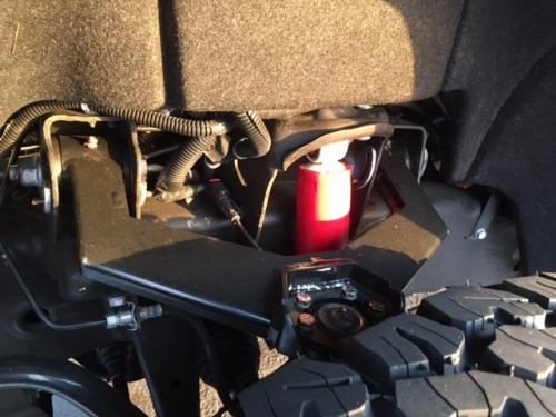

I did a lot of research on this too before I decided which way to go as I obviously needed to correct the stock stance. My last truck was an '04, and a simple crank of the bolts is all that was needed. It did prematurely wear out the idler and pitman arms (had to replace both twice in 150,000 miles). You can do this on the new trucks, but from what I found out, it will too prematurely wear not only the idler and pitman arms, but the upper ball joints. Adding aftermarket UCAs, a front differential drop down spacer, and shock extensions (or longer front shocks) brings these angles and/or gaps closer to being happy.
I decided on a leveling kit from Central Coast Motorsports. It consisted of UCAs, keys, diff drop down bracket, and shock extensions. They manufacture their own UCAs. These kits are similar to those made Cognito, Rough Country, etc...but are much cheaper. To get my truck level, we needed to lift the front approx 4". CCM states on the 2015 or 2016's, some trucks only need to be lifted 3" and some are up to 5". You would think they would all be the same from the factory.
The ride did slightly stiffen on the front end after installation, but it is not bad. I actually like it better as it is more truck like...not so soft like it was...

I also installed BFG KO2 tires. These are 1" taller than the OEM car like Goodyear's that came on the vehicle. This also made it look more truck like...plus these will perform much better than those "all season" car tires...

Looks great ! What tire size are you running ?

Hey I'm looking at a similar set up can you tell me your total height? I am curious if I can still fit in garage afterwars...
Without having my long level (I am at work) to come off the rear off the middle off the roof or the shark fin, I can get you a somewhat accurate measurement using a 12" level off the top corner of the rear glass on the rear door. This height is 75". If you compare this to your truck, you can probably tell how much higher mine is versus yours versus your garage height. Also, just for comparison, the center of my front fenders are 42.75" from the ground and the center of the rears are 43.5" from the ground. Hope this helps ya...
