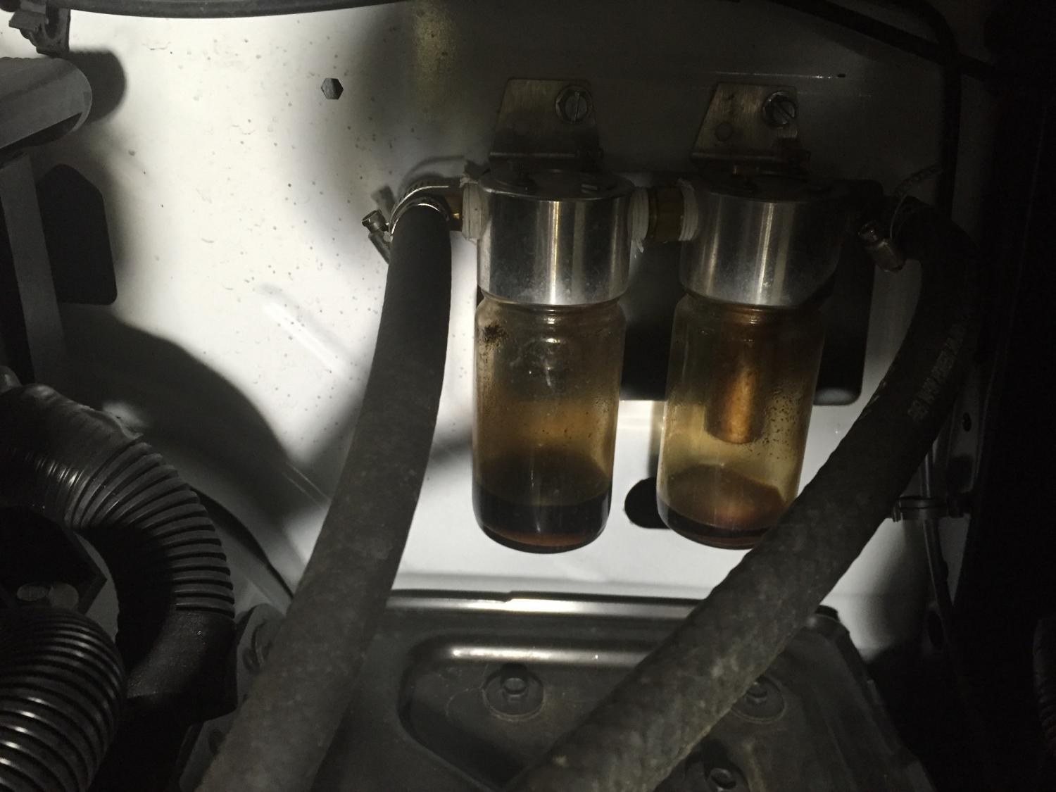

One thing that I would have on a DI motor is a PCV line oil filtration setup, or "catch can" as some like to call it. One of the worse things for DI intake valves is oil residue and vapors coming thru the PCV line and into the intake. I cakes up on intake valves. Even port injected motors with AFM can benefit. I used a catch can setup on my 5.3L and moved it over to my 2500 6.0L when I traded up.
This is just from the 6.0L. The 5.3L was even worse. See if you think this junk going to you intake is a good thing. Picture was done one evening recently. Not the best. But there is about 3 oz of oil in the first and the second stage gets what the first missed.
