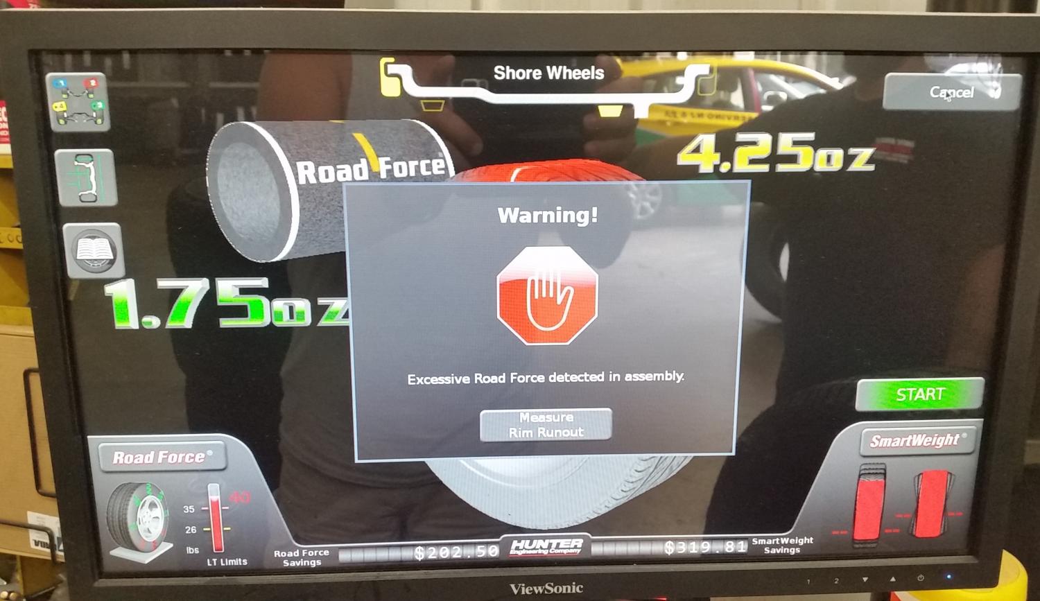

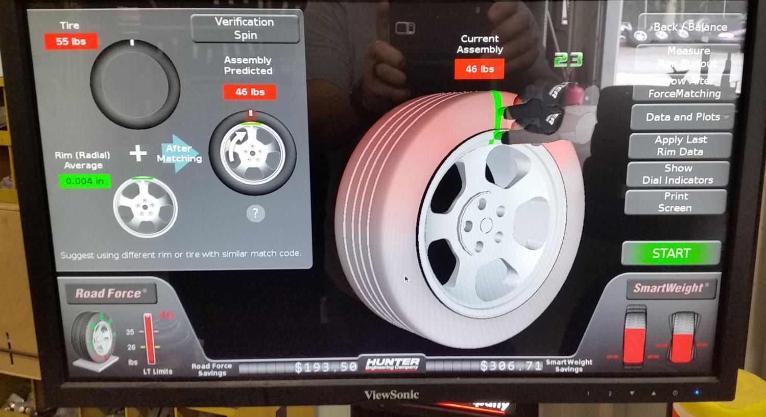

Had it back to the dealer 3 times for anaylsis.. They rebalanced and road forced them multiple times before I took the truck to a shop that had a new Hunter Road Force balancer.. I stood in amazement as I watched a brand new tire roll a 61 on it.. Turned out all but 1 tire was good the rest were 32, 41 and 10.. I spent the next 3 weekends driving tires back and forth.. I went thru 9 new Michelins to find most RF'd over what GM is now calling good which for those who are having issues that number is 15 lbs. DO NOT ACCEPT ANY TIRE ABOVE THAT NUMBER!!!
For those who have issues, I recommend getting on the Hunter website and locating a shop that has this piece of equipment..

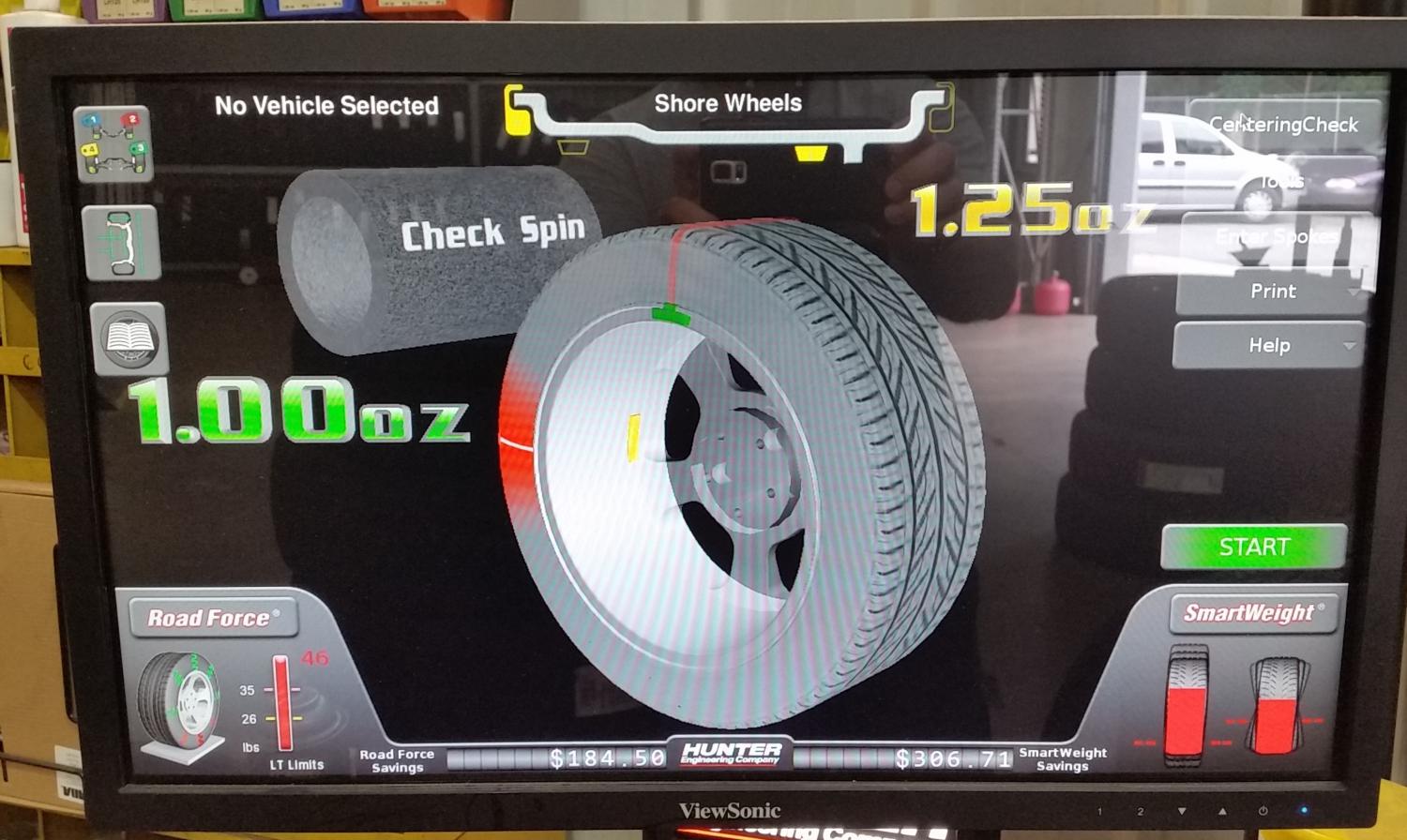

FYI... The standard Road Force for LT tires is normally 30lbs... GM has lowered that to 15lbs... I can tell you that you want less than 15 lbs I had one that was 13 and I could still feel it slightly..
Also the tech that is mounting the tires plays a huge role. If he does not pay attention to the manufacturer placement marks on the tires (yellow or red dots/stickers) that will have an effect on what the outcome will be.. after bringing my truck elsewhere i found the original tech didnt do this and it had a pretty big effect on how much weight the wheels took...
