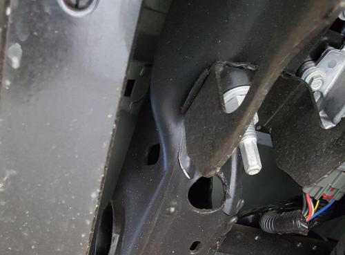

So my 2016 Silverado LTZ that has less than 5000 miles on it took a pretty decent hit this morning on the way in to work. For the most part, the damage looked like it was just bumper damage, but upon further inspection I see that the trailer hitch mount has been pushed up into and appears to have cracked the frame. Is this repairable, or am I looking at them having to replace the entire frame?
Sure it can be repaired with a new frame. Hope you have the other guys insurance info.
I did, the police did a full report and cited the guy that started the chain reaction. Not looking forward to being without my truck for however long the repair takes. After fighting with vibration issues in the first one, I was loving this one and had no issues at all....until now.
New frame. You can't properly weld on HSS to repair. Depending on your state laws it may be totalled. That's what happened to my 2014. Frame replacement = totalled in Texas.

Can't believe that this accident is resulting in around $17k worth of damage. They are ending up having to completely replace the frame and the bed over this. Crazy how much damage can be hidden just below the surface.
I had the same thing happen to me. If the frame damage was all rear of the front mounting points of the rear suspension, I would at least investigate having the frame pulled rather than replaced. Make sure you push for deminished value.

From what I was told by the body shop, according to GM specs, once a Hydro-Formed Steel frame damaged, it almost always has to be replaced (mainly because it cannot be heated to repair). Fortunately this is all on the at-fault drivers insurance so it's not costing me anything more than being forced to drive a rental for about a month. Both the insurance company doing the repairs and the body shop (recommended by several GM Dealers in the area) all have lifetime warranties on the repairs, so if there are any issues as a result of the frame replacement, they will work to repair those.

I'd prefer the new frame every time.

I had all 4 body shops tell me they would pull the frame no problem. I questioned it by asking if they were willing to put their repair on the line if I tow max weight at highway speeds. All of them said as part of being a certified Gmc repair center that they had to garantee factory specifications for tolerances, payload, towing ect... I had no choice.
