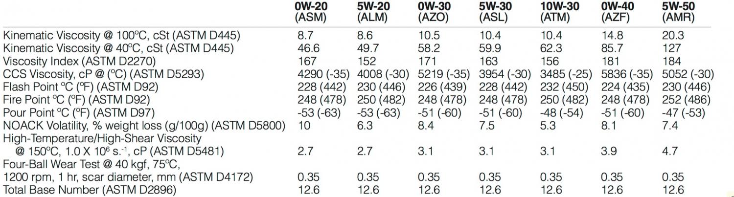

I think blowby was probably the issue but what has most likely fixed or suppressed your issue is the heavier weight oil that you used. It would be harder for the heavy/thicker oil to finds its way into small spaces to form the blowby. One thing to be mindful of (Although in all honesty it won't hurt a thing in the world) but vehicles are designed to run a certain weight oil for adequate lubrication. The oil pumps are also made for whatever the design weight was intended to be. Just as a disclaimer it is never a good idea to use a different weight oil than the vehicle was designed to run with to ensure adequate lubrication, but as I mentioned above it probably won't hurt it.
True, engines are designed with a certain weight oil in mind, but your assertion that I used a different weight oil is incorrect. I didn't use a heavier, different weight, different viscosity oil. A 0w30, a 5w30, or a 10w30 are all 30w oils and have the same kinematic viscosity at operating temperature. That's ok, a common misconception by many folks that they are different weights. The only thing different between these oils I mention is the cold flow rate. The "w" doesn't stand for weight, it stands for winter. Check with the API website, it says so. The 10w30 does have a much lower NOACK (burn off vaporization rate) than the others, simply because it is more base oil with less viscosity improvers (VI can shear and break down under many conditions) because it doesn't need as much. Take a look at this chart, especially the 0w30, 5w30, and 10w30. The kinematic viscosity at 100c in virtually identical. They are a same weight oil, with a kinematic viscosity of around 10.4 to 10.5. Also, viscosity is not thickness. It is resistance to flow. Ask Isaac Newton in the next life and he'll explain it to you. So, contrary to your assertion, I did use a viscosity of oil recommended by GM (30w). I just used one that has a slightly higher winter flow rate. The oil pump will have the same work to do with a 0w30, 5w30, or 10w30 at operating temperature. And bearings, cams, rings, etc will not notice a difference either at operating temperature. Only at cold start up would the pump notice anything different, and then, with a 10w30, only if I was in extreme cold.
The only reason GM recommends a 5w30 many times is to cover the broad range of users from the Rio Grande to Canada. Someone is south Texas would never see the need for the cold flow rate of a 5w30, but it would work. While someone in Duluth, MN in the winter would definitely benefit from a 5w30. So GM just blanket proclaims that they recommend a 5w30. They realize that many folks make the same mistake you did and they just account for that. And using the same mindset, that is why they never allow a 10w30 on the approved dexos1 oil list, even though in many cases, a 10w30 will outperform (because of being more shear stable and other factors) a 5w30 or 0w30.
I know this is new to a lot of folks, but relax, there won't be a test next Friday on it! :lol:
