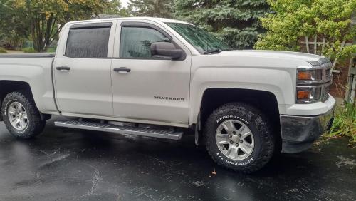

Threw them on today. Running them on the factory 18" wheels. No rubbing so far, they are +1 size, should not rub. I think they look great and ride even better. I actually like the stiffer tire. I feel more connected to the road. the SRA's felt like pillows. Currently running 45psi in the front, 40psi in the rear as I'm empty 90% of the time. I'll get some pics up later. The OEM SRA's were rated for 2,469 Lbs @ 51psi. GM's door sticker called for 35psi. The door sticker says 3,950 Lbs per axle for max gross weight. I found a few inflation charts for E rated LT275/65R18 and they show 40psi as being plenty, 45psi if I'm really wanting to error on safety's side when loaded. I've also put some paint marker stripes on the treads. See how the 45F/40R does on wear pattern. But somewhere in the area of 40-45 is where I'll be running them.

Pics?? I bought the Bilstein 1500 adjustable ride height shocks to give me 1.8" in the front and bought the Bilstein 1500 to replace my back ones. Thinking of running 275/70r18 KO 2s. Would like to see what the 65s look like compared to the 70s.
