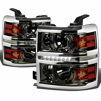

Was looking at these headlights with an HID kit or the LED. Sounds like the Morimoto kit is the way to go.
Those look nice! When you order the HID kit make sure you order the correct bulb size for those after market headlights! Have you looked at the winjet or anzo headlights?
Just make sure they take the same bulbs. The OEM projectors use an H11 bulb but many of the aftermarket ones actually use an H1 bulb (they are slightly different sizes and light output).
I like the winjet a little better simply because they look like a little better quality over the ANZO. i have heard the anzo can be a real pain to adjust the up and down to position the lights and the quality isn't as nice as you would expect with a $400 + investment. I could be wrong and thats why i value everyones opinion. Thanks for the info on the correct bulb sizes as I did not take that into consideration. Thanks guys!
