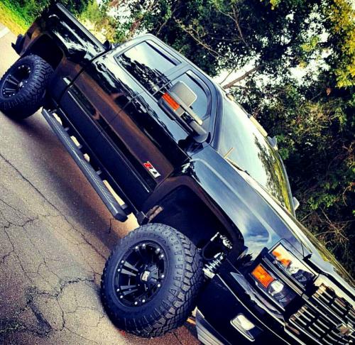

I just had a 6 BDS with fox front and rear installed on mine. Its way better then stock. (I had the z71 package with ranchos) Your right the reason you cant use 18" is the backspacing and you would rub the tie rod. I am using 18" i just went with a -24 offset and a 33" tire. (Changing to 35" this week) I had no rubbing with this setup. My buddy has the basic kit and you can definitely tell the difference. Not sure if 37" will fit. Check out this website. You can put in your truck and what size lift, tire and wheel combo your looking for. Alot of different trucks with different setups on there so it will give you a idea what will work and what wont. If you have a local BDS dealer order through them. You dont have to pay for shipping if it's shipped to them. (Its expensive if shipped to you) I also got 15% off my lift. My local dealer said any local BDS dealer should atleast give you 10% off.

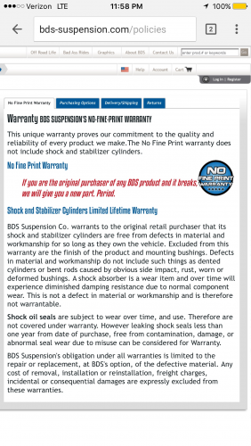

90% sure if you tried 37s on 6inch BDS it would void their warranty since their fitment guide only allows 35s with a -6 offset. Outside of that you are on your own for any problems that occur regardless whether it fits or not. I would check this first.
One is functional and one is just for looks.
Not sure I follow. I'm trying to chat with them about this now, from what they are telling me 37s will fit, which leads me to believe that it won't void warranty but def something to look into.

I strongly suggest reading the BDS warranty yourself.
There warranty is straight forward. Nothing about what size rims and tires you run. It is there products, not what is surrounding them
