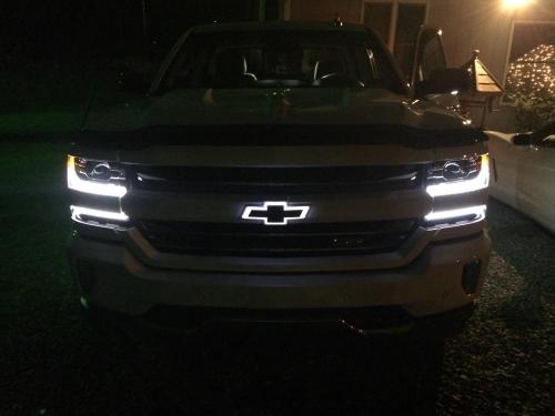

I have just put it on front grill will post pics after dark fit perfect

You have a pic of the final installment on your truck? I want to see it on your grill please
