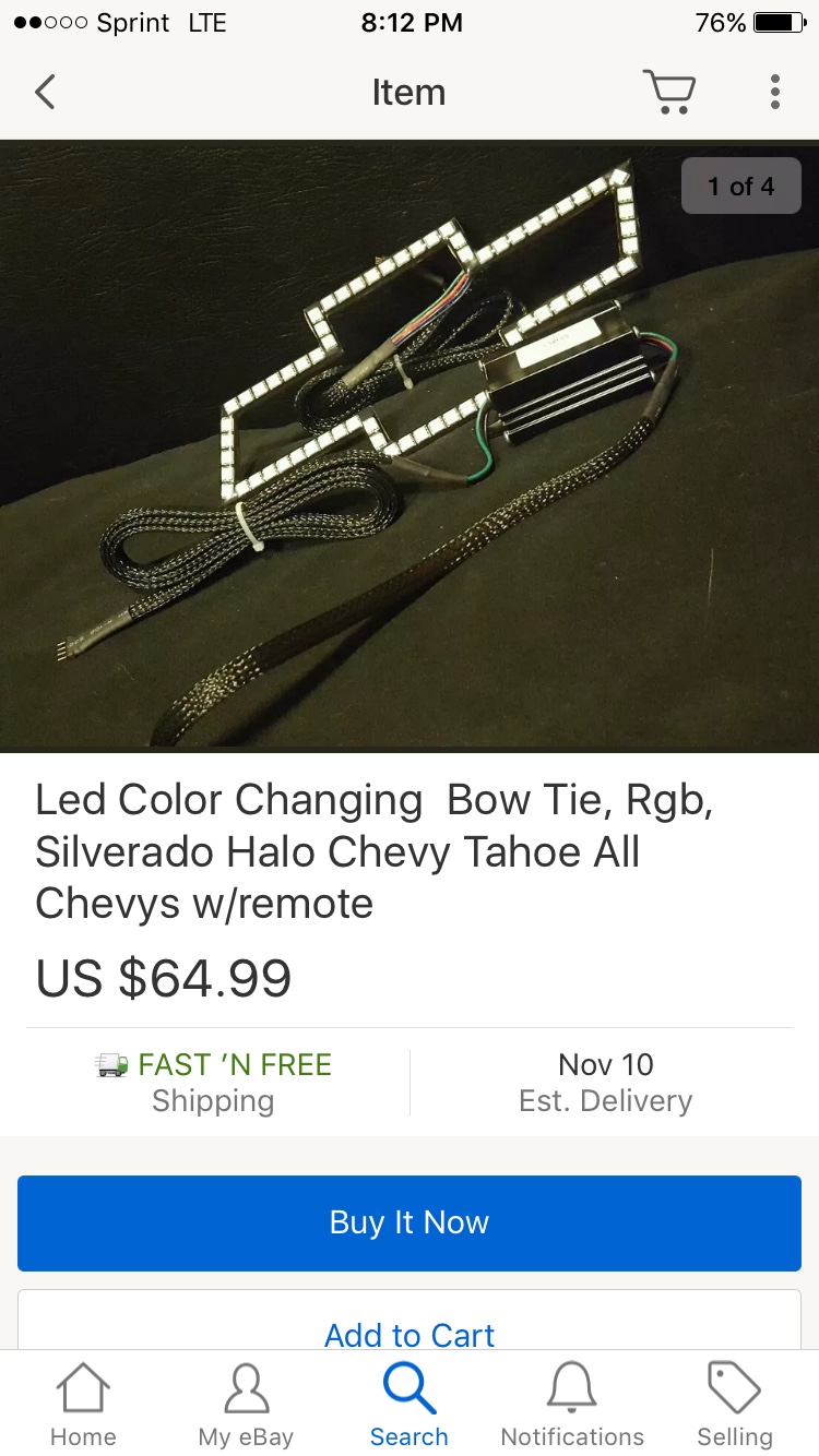

I'm already working on a prototype for my 15.. I let y'all know what I come up with.. it involves making a negative mold of my existent bow tie and melt clear plastic to run an LED tape or wire in it.. ideas are welcome.
