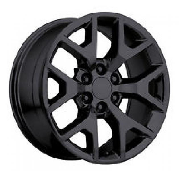

They do look like replicas in the pictures. They look like they could be 22's which would explain the sidewall height. I am keeping my name at various dealerships for new vehicle take-offs as the risk of buying from unknown sources is higher. You really need to be diligent when buying used rims. These particular rims are worth looking at and meeting the seller. Maybe the seller believes they are OEM but they came on a used vehicle....

Those are replica wheels, not OEM, but if you like them go for it!

This looks like the ones pictured above to me.

You can see a difference in the Y spokes on the wheels.

This picture is from the back side of the wheel. I was expecting to see a GM logo or something and this is what was sent to me. Does this match the backside of any of your wheels that are FACTORY OEM wheels.

Imo those are aftermarket wheels. I'm pretty sure all GM wheela would have a GM stamp or something I'm off that nature. Tell the seller to send you a picture of the wheel where it shows the GM stamp.

Those are not GM wheels, the GM wheels also have another production stamp on them as well.
