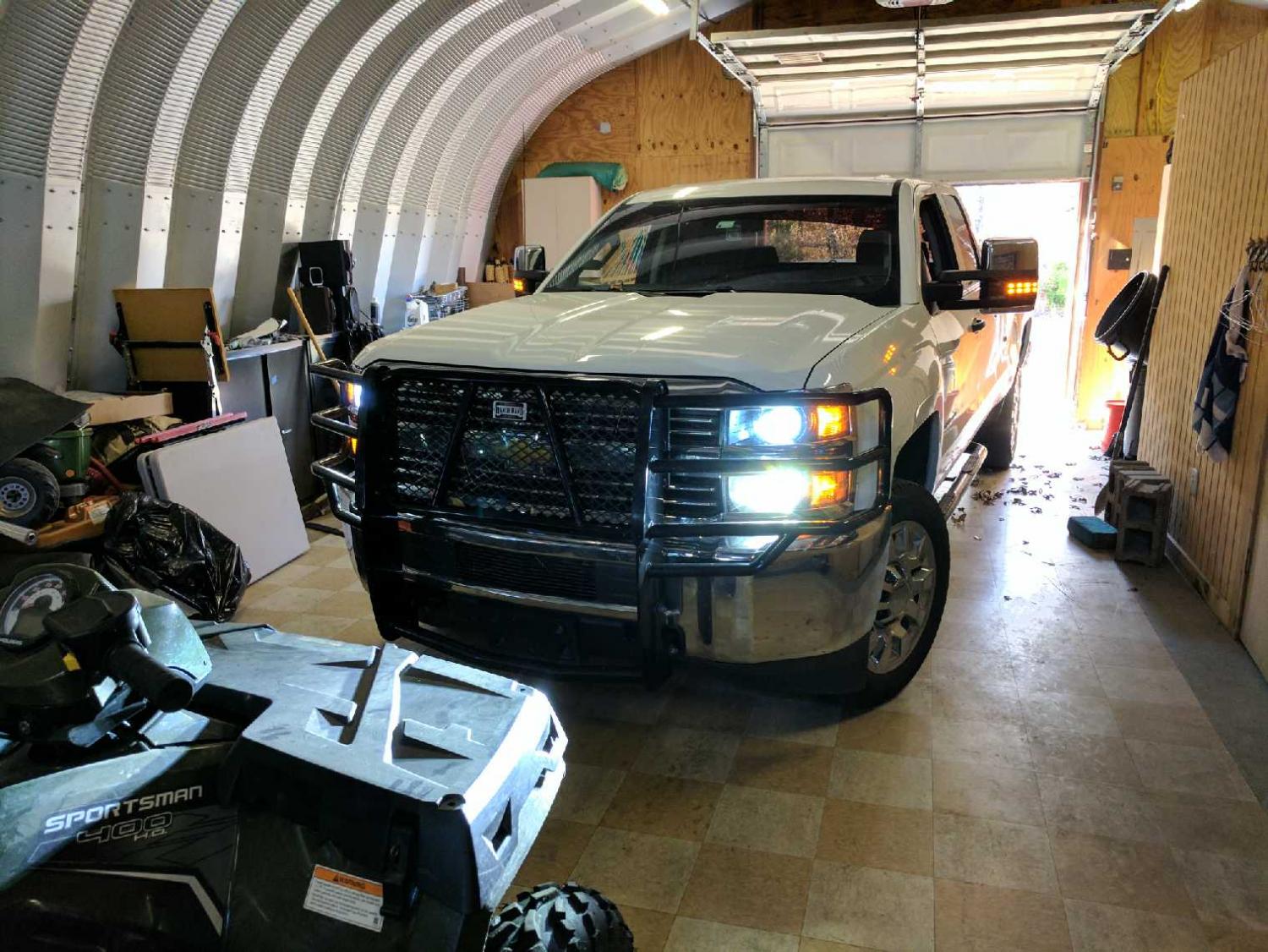

I find the current Chevy design excellent assuming you swap in some HID's... They responded well to my HID install aim was still great and cut off is like it should be...
On the headlights themselves, No issues with melting housings, they never leak moisture in the lens, and the high beams come on top of the low beams which means (with my LED high swap) I have a massive wall of light in the rural roads, my vision isn't great but it's like daylight in a highway through the forest lol... There is even a perfect amount of light bleed from the factory lenses to light up the street signs real nice without ever getting flashed by others...

I was definitely not happy with the stock headlights on my truck, and bought an HID upgrade kit. Worth every penny. Had to adjust the aim higher just a tad from stock also. I could care less about fog lights, they haven't helped me on any previous vehicle I've owned.
