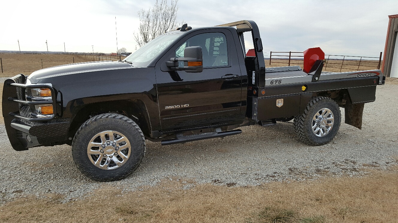

Out of the box, I put a RanchHand bumper on mine (much better front clearance), Nitto TrailGrappler MT's (275/70-18), and cut about 12" off the tailpipe. Goes great in the goo and deep ruts around here with the short wheelbase of a regular cab and a 2000 lb flatbed on the back.
The limiting factor offroad in these trucks is the 3 or so inches of suspension travel. Get going very fast and this thing bucks like a wild horse in rough terrain. Suspension mods will be my next project. When I get more clearance I'll put a bigger tire on it.
What kind of terrain has it been in? Our work dually has 245 wide mud tires and handles all conditions really well. It has extra leaves in the back to deal with the weight of the bales & box feeder. Around 14k loaded up. The only major issue is high centering (crew cab long bed). Having a regular cab like yours would really help.

Lots of mud, especially lately with all the rain. I added airbags right after I got it to help with the 2 1500 lb bales I carry on it. Carry about 25 lbs of air in them. My last feed truck (same config as this one) I went with the heavier springs and really liked it. Also had Bilstein 5100's, Kryptonite upper arms and aftermarket steering components and keys. Eventually, I may do the same to this truck. The 6.0 is all the motor I need. Pulls my loaded 20 foot stock trailer fine and these engines are tough as nails. I got rid of it because of transmission issues.
I can't speak highly enough of these Nittos. I have tried most of the mud terrains out there and these things will sling mud and clean like no other. You can get better but not with this stiff of sidewall that can handle the weights we haul around.
