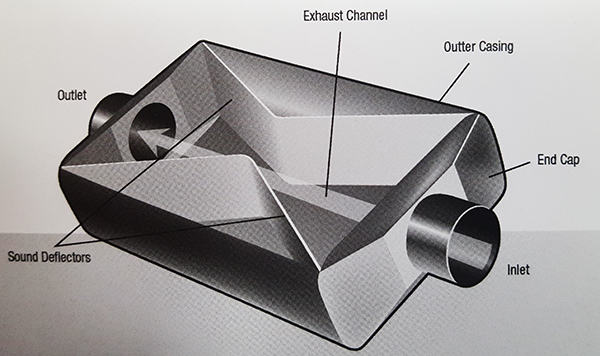

Never heard of the Black Widow - interesting hour-glass design inside - beats a straight pipe I bet - lots of loud as hell sound clips on their site under the link LISTEN.
