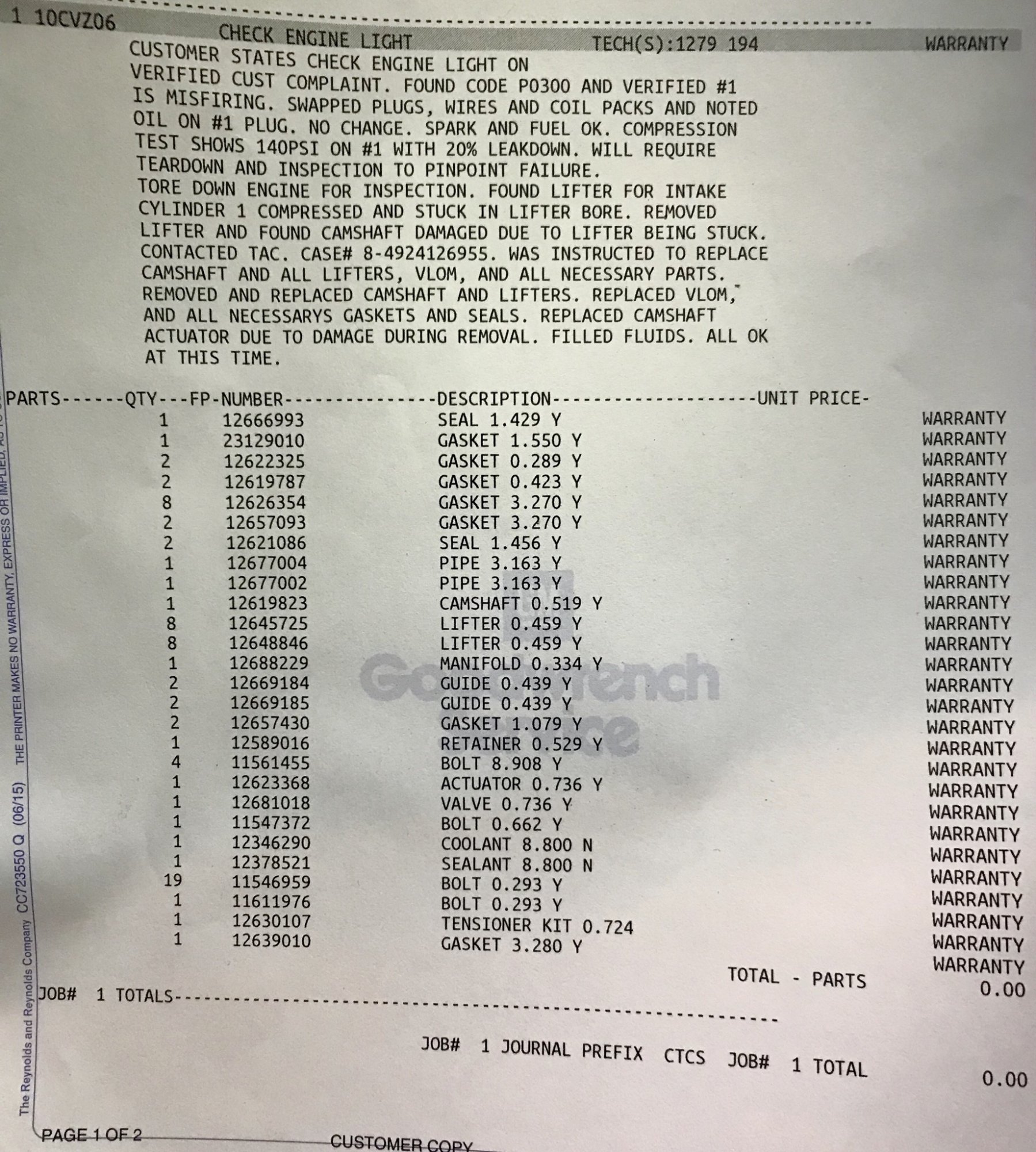

Newdude is right. I just had my POS 2015 Silverado fixed. I first had the P0301 code, and replaced the plug, wire, AND the coil pack. Then it threw the P0300 general misfire code. It also reflected the safe mode with blinking check engine light. I took it to the dealership, and LUCKILY mine was still under warranty (5yr/100K). When I referenced what Newdude said, they agreed and replaced the ENTIRE bank of lifters, and the camshaft. For those of you who may want/need it, I’ve included a pic of the maintenance order. All of the work was done by the dealer.
I still HATE this truck with a passion and will be selling it within the coming months. Worst truck I’ve ever owned by far.
