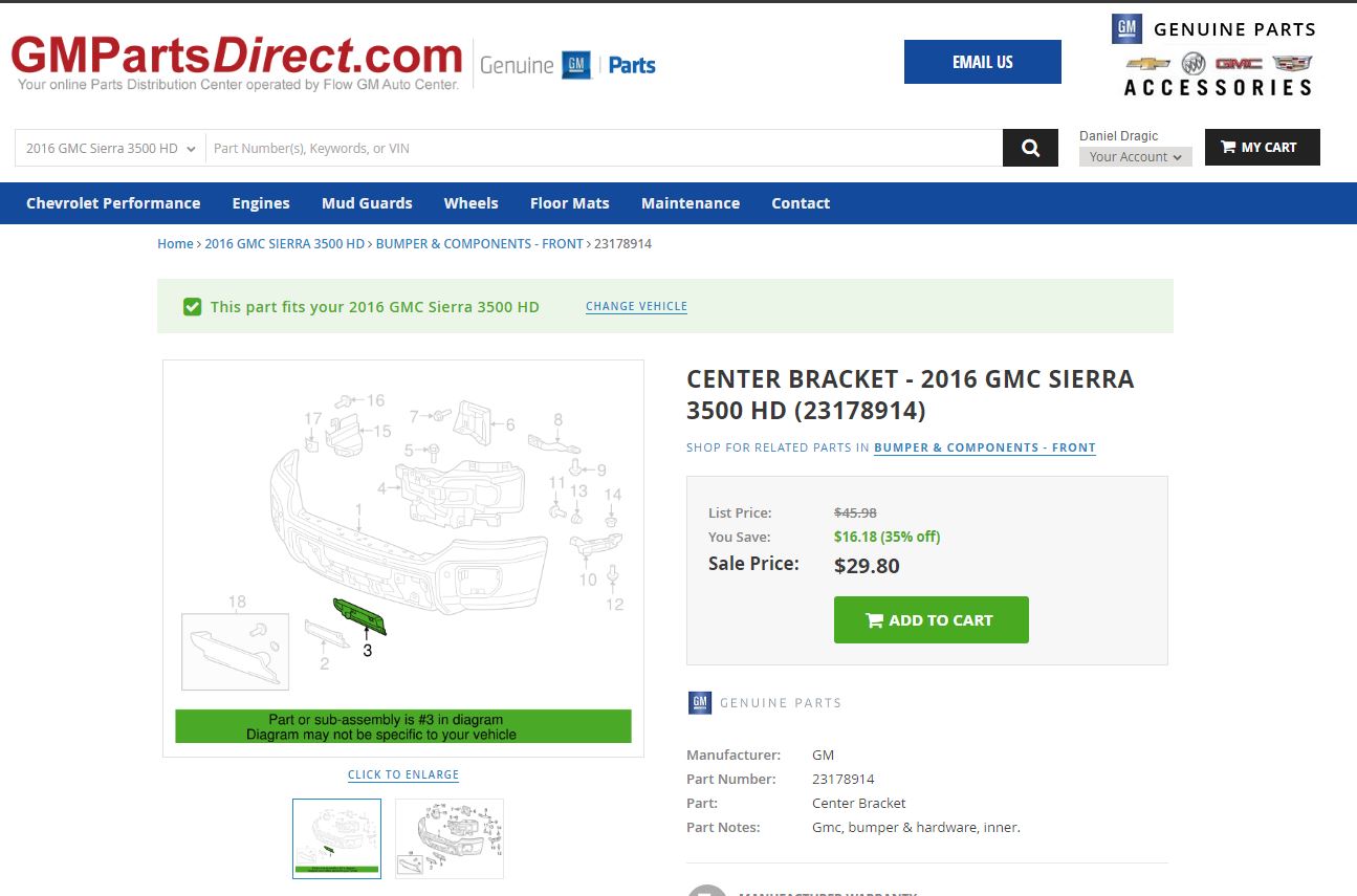

can someone confirm that I need the part #2 or #3 highlighted in the attached? Or is it a different part to hold the license plate? I have #18 in the diagram.
thanks in advance!
Daniel
Looks like #3 to me. I would give the a dealer parts dept. a call and see if they can help. As far as removing the chrome part it probably snaps in, the licence plate bracket screws in from the front. Again a dealership service dept. will probably give advice if you ask.
That piece circled. On the GMC HD, there are 4 screws that hold it in from the back side of the bumper. Pop your head underneath and you will see them.
Once you remove the cover, you will see the holes for the license plate. That cover hides it for states that do not need front plates, and when removed, it is front plate state compliant. No separate plate bracket.
thanks guys... I'll take another look under the bumper and maybe I'll stop by the dealer as I pass it on my way home every day anyhow. Normally this stuff is easy for me (I have an affinity to taking engines apart and trying to put them back together) but I always get stuck on the easy peasy stuff... :-)

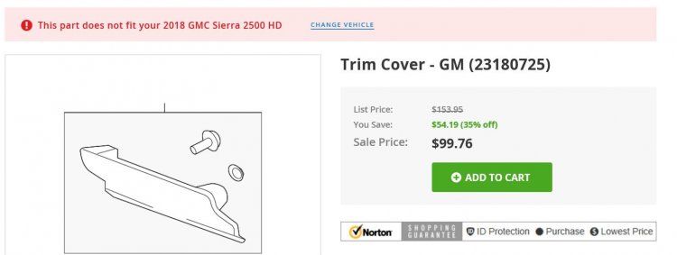

Where can I find just the chrome cover?  My 2018 GMC Sierra Denali has the bracket for the plate (which I don't need) but I would like to have the chrome cover.
...the dealer...
In all serious, you will need center cover kit 23180725.
29 minutes ago, newdude said:
...the dealer...
Thanks, but this says that it does not fit....
It fits.  Trust me.  Ignore gmpartsdirect.com.
Thanks!  I think smartdude is probably a better name for you.
