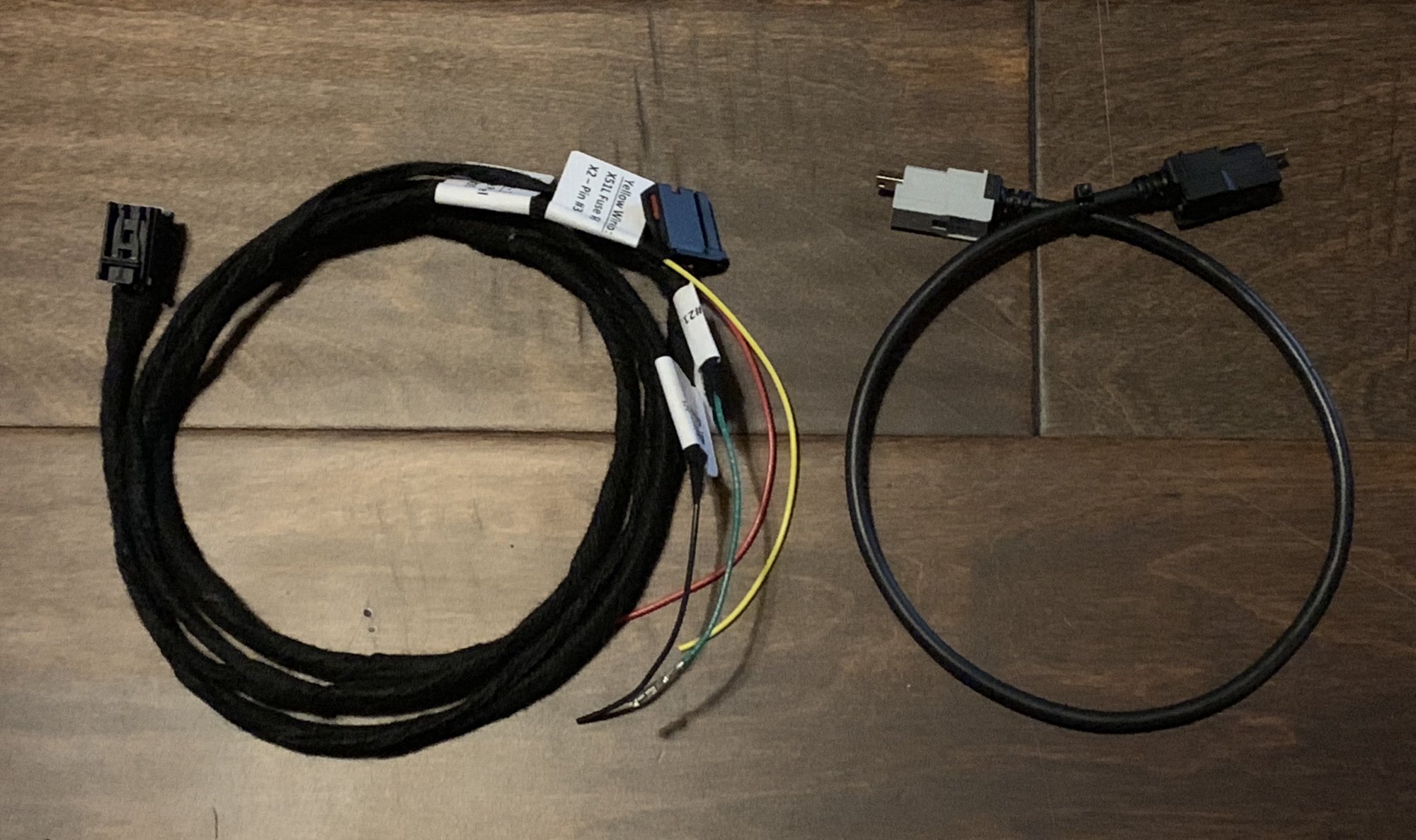

Nice Work!  For anyone that is looking at doing this MOD, I have am now offering the harnessing for this upgrade.  It is $150 shipped, Canada +$10.  It will also include the USB Cable needed to go from the Cluster to the HUD Switch, and full instructions on how to land the wiring.
Please PM me for ordering this harness.  Thanks!

My HUD wire harness just arrived in the mail. It has easy to follow instructions. The pictures along with the instructions makes easy enough to install.
Thanks to Viktorrocks15 and pgamboara
