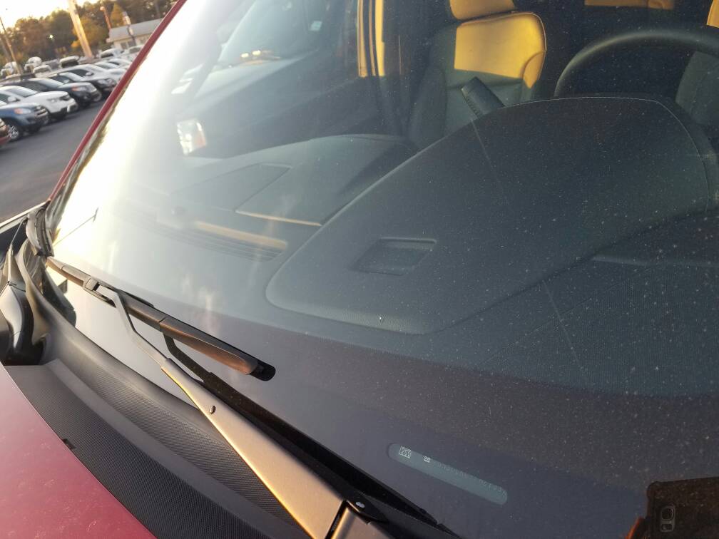

Not a great pic, but the Denali visor cutout for the HUD is indeed larger than the collision detection cutout.e72d6c4d459346832327b5940ed2ec78.jpg
I looked at my truck and a Yukon side by side and it looks like the defroster panel is interchangeable but there's no way to tell for sure without measurements or buying one to try out.
Sent from my SM-G935V using Tapatalk
Edited by stereojnky
Good pics. Lot's of obstacles to make this happen on the trucks...the biggest might end up being the wiring to the switch and HUD unit itself. I'm starting to feel more like the visor and defroster panel might work. One of us will just need to go for it..
