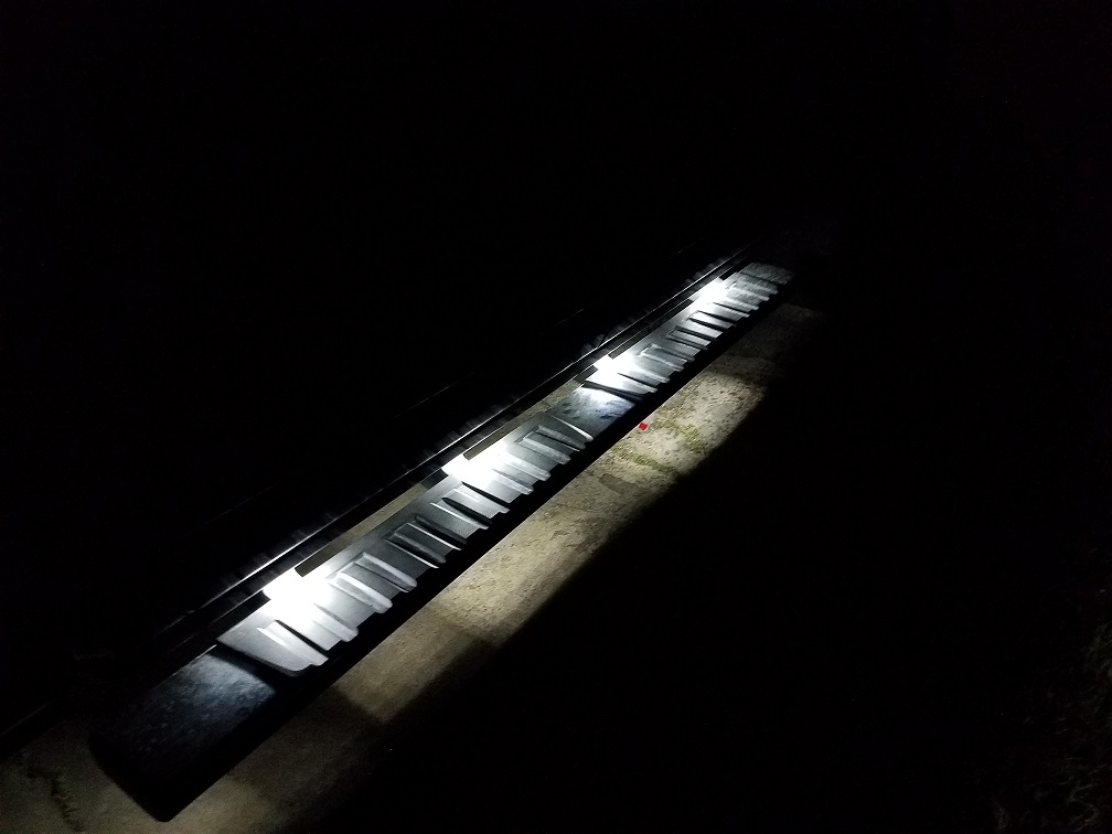

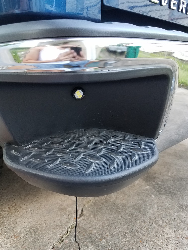

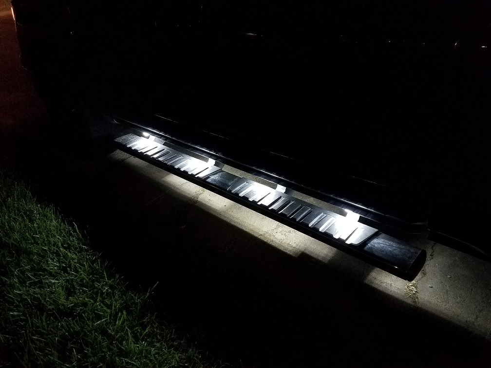

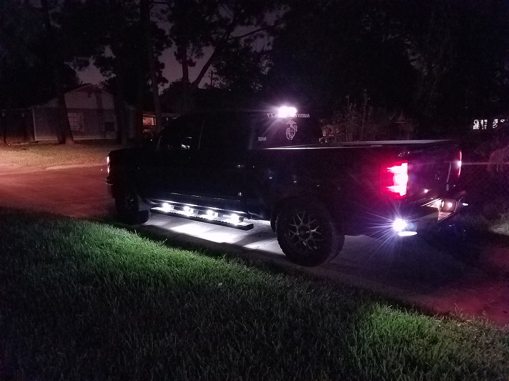

Started changing bulbs to LED. Started with the reverse lights, cargo lights and license plate lights. Also added small 1" LEDs to the rear bumper steps and tapped them into the reverse lights and installed some LED step lights. I used a truck bed light kit I got from Walmart for like $18 I think. They work great.

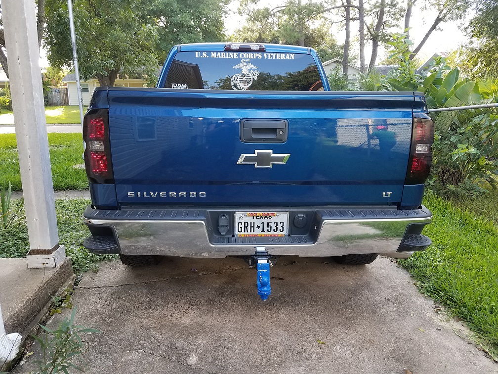

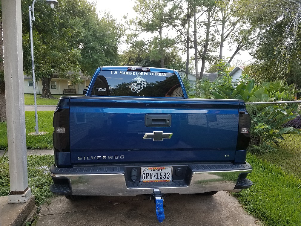

So, I recently tinted my 3rd brake light and taillights with VHT Night Shade and they actually came out better than I thought or expected. The taillights are a little darker than I'd like but I ended up having to spray an extra coat because gnats decided to get stuck and leave little tiny foot prints on one. So after I removed them I sprayed them both once more. Good thing about this stuff is you can remove it and spray it again.

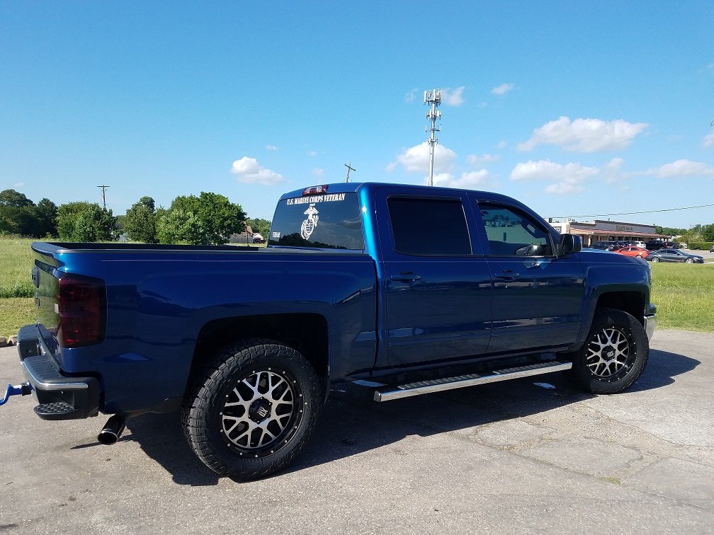

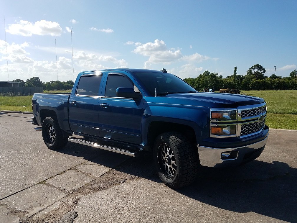

Got some new tires put on, went with a 305/55/20 this time and the Falken Wildpeak AT3w's. So far I like how they ride and they look good. I really need to lift a little bit higher now though

Care to share some close up shots of your nerf bar lights? I'm really liking how they look and curious how you mounted them etc..

Sorry for the late response, I'll try to get some close ups and post them up. I just cleaned the surface really good and wiped it down with alcohol, then just used the 3M tape that came with the lights to stick them on, they've held pretty damn good so far, I'm impressed. Only thing now is, they've gotten a little dim and I need to replace them so I hope they come off easy. LOL

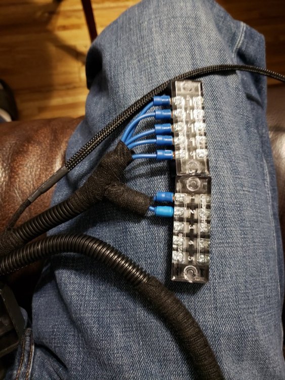

I've purchased the dual 3" LED fogs to replace the factory ones but just haven't had time to install them yet. I just got the lights for now, no brackets. I think I'm gonna use another member's idea and mount them to either the plastic housing or the bracket that holds the housing in place.

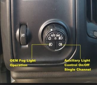

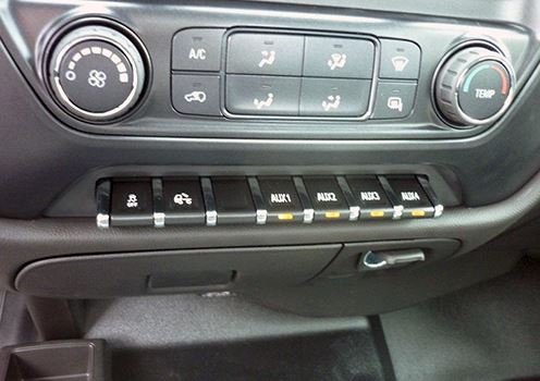

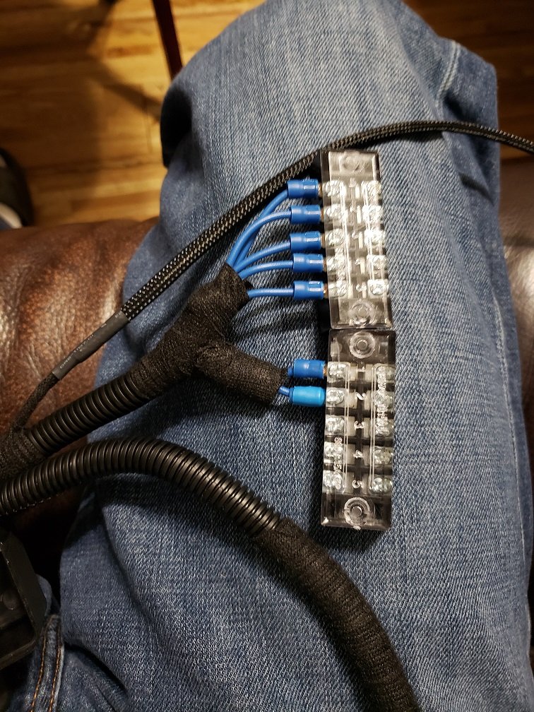

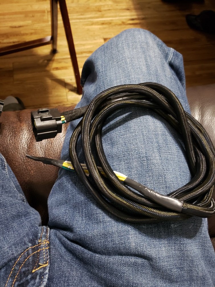

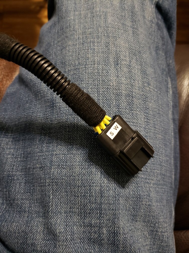

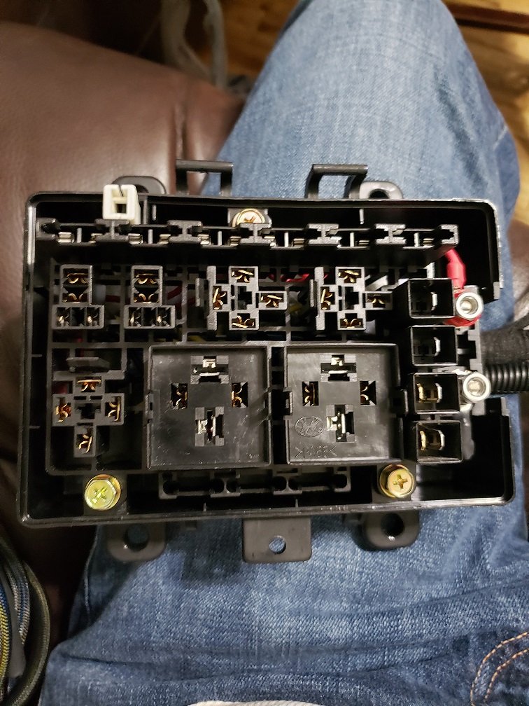

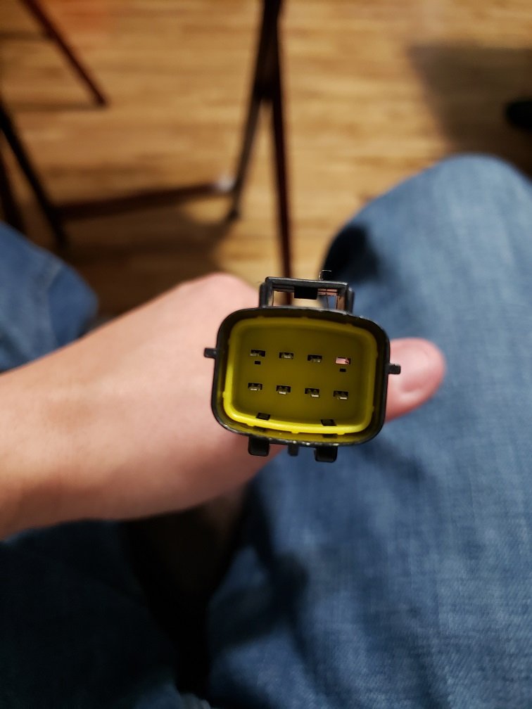

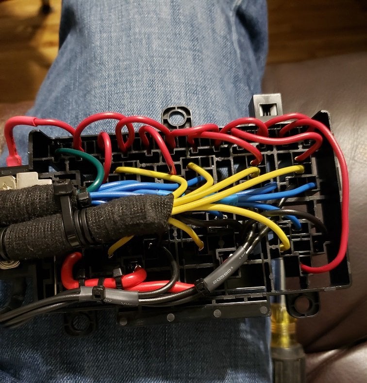

I've also bought a fuse/relay box to add to the truck to make adding additional accessories that much easier. Plan on mounting this on the second battery tray. As for the switches, I'm planning on adding the factory switch panel with the 4 additional AUX switches that goes under the AC controls and the factory Offroad light switch that replaces the original light switch. Since these pics were taken, I've replaced the two 5 port connectors with one 8 port for a cleaner install. I also installed a quick connect plug for the switch inputs with a 7' pigtail going into the cab, in case I need to remove the fuse/relay box for any reason, I can just unplug it and disconnect the outputs, power and ground. On the other end of the switch pigtail, I'm going to add another 8 port connector somewhere under the dash where I can just connect the inputs from the switches.
