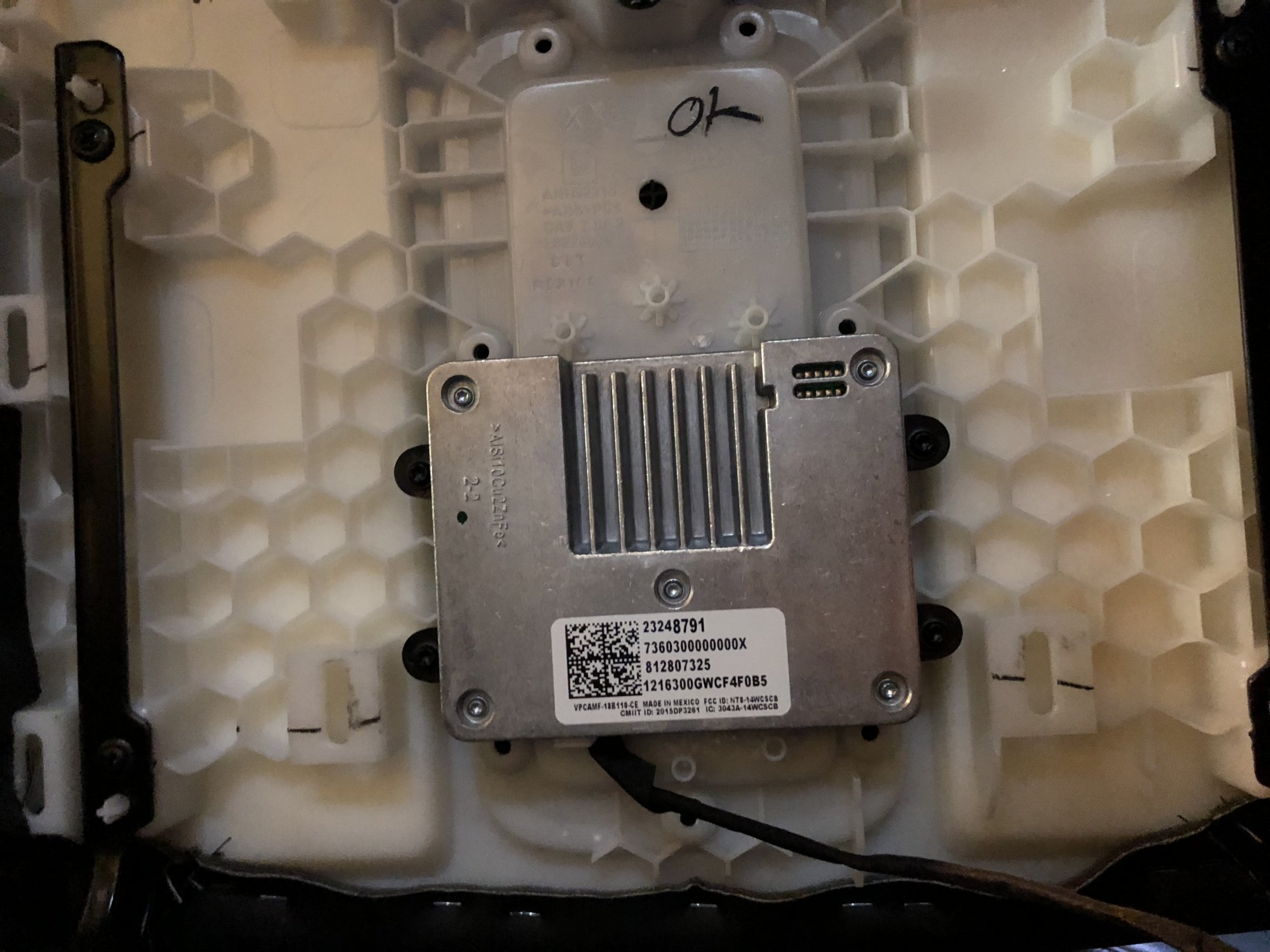

Hmm.  What is the part number on your charger?  Perhaps there are different ones out there?  Mine is 23248791.
You could try to unplug the harness again from the module, then try plugging in again?  Perhaps there are different states that the module can be in when first initialized by plugging in?  For me, I could have sworn the first time I plugged it in, the connector was tight, but then nothing appeared to work.  When unplugging it, then plugging it in again with the phone on top of the charger, it seemed to work afterwards?  It wouldn't make sense either if the charger consistently had power even with the car off, because then it would just drain the battery.

This is a picture of mine.  My vehicle was built near the end of December 2016.  Maybe there are variations in modules across different time periods that still have the same part number?

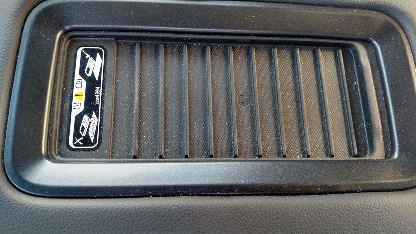

Some have said that the rubber console mat (or as GM calls it, just "LINER") is different, or at least a different part number.  From the pictures I have seen on chevrolet.com, it looks the same compared to 2017, but it's possible it could be different?
2017 mat:
2018 mat:
The 2017 mat has 9 raised bars on the surface, while the 2018 mat has 10 raised bars. The bezel is the same between the years. I changed mine out with one for a Yukon Denali, so it is a brushed metal finish.

looks like the only thing GM did with the liner is shortened that back bump stop, allowing the phone to sit toward the back more where the charger is placed. you could accomplish the same thing by rotating an earlier model year liner
