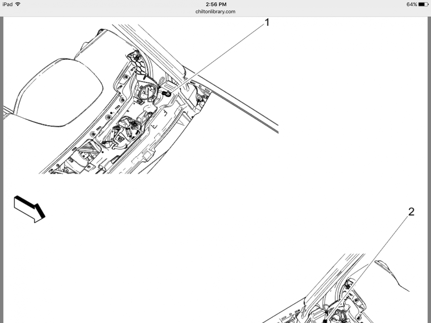

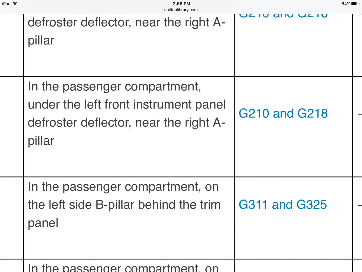

Look at the link I posted. The G218 ground is way up in the front left corner of the dash. You need to remove the pillar trim, then the front cover of the dash near the windshield, then usually the front dash speaker. Then when you look down in the far front corner you can see the ground stud they are talking about. There is a similar one on the passenger side that doesn't seem to be a problem but you might as well check it while you have everything torn apart.
thanks of that info, can you tell me where the G218 connection as maybe i can look at it myself. you explaining a drop in voltage makes me wonder if i caused it myself. as i had said we were camping and i may (can't remember) have raised my Travel trailer using the electric jack with the engine on the truck turned off while still hooked to the camper, i do know the jack draws a lot of power. do you think that could have happened
Here is where it is located number #1 on image
Thanks looks like it will be a bear to get to
