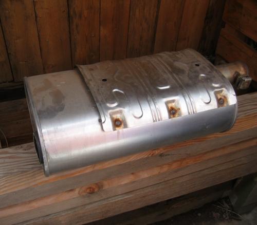

Today's upgrade I should have done day one - FlowMaster 50 Series Big Block muffler swap.
OMG - Sooooo happy with the new sound and so is the wife - she says it sounds like a truck now. You most def can always hear it now - but never is it obnoxious - not even at WOT. Just a nice mellow tone from idle to 75mph and no drone - no chopper - even though I planned to leave the flapper - but didn't say anything about it and they cut out the flapper too. No flapper to rattle or get stuck - the muffler shop says they do see them get stuck.
Neither of us hear any difference in V4 around town or on the highway....
One big plus I hadn't planned on - now I can hear it shift - which helps feel it shift - before I hardly knew when it shifted. Something tells me this will not be good for MPG - it will cause lead foot syndrome........... :driving:
My choice was FlowMaster # 53553. Resonator retained. Flapper removed.
Also MagnaFlow # 12909 would probably be a good choice.
I have always been a FlowMaster fan. I have been hauling the FlowMaster muffler around in the cab for a week debating it.
What got me to finally pull the trigger was all the muffler delete threads - I thought that can't have a good tone - yet people like it - so no way is the "quietest" FlowMaster going to be too loud.......
