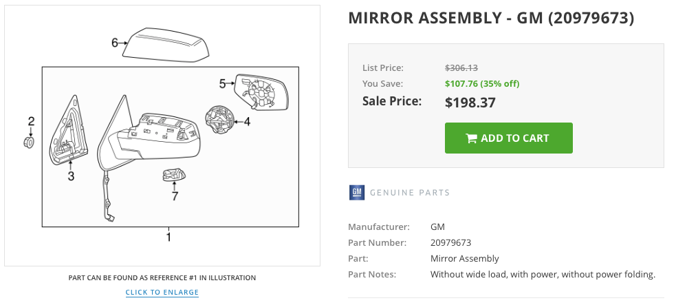

I don't believe there is a service part for this. The mirror comes complete when it's ordered, so there's isn't even a part number available for this. I'll see what I can scrape up at my dealer for you when I get to work Monday.
It looks that way...
I would assume you need the dl3 housing because of the lamp on the bottom of the mirror. eBay for a broken mirror would probably be the cheapest.
I found one on eBay a few months ago. Not ready to find but if you look hard enough you cab find one. Also a pain to swap out. I'll add pictures when I get home to help you out.

If your mirror was not a DL3, I would have gotten you taken care of.
This is a DL8 mirror and know the feeling. I was too lazy to get a blow dryer to heat up the stick on mirror and broke the glass trying to remove it. Since this was (what appears to be) a total loss, I started tearing it open. It seems that the housing is two parts, clam shelled together. I'll take a look at it tomorrow. If it separates easy and you can you it, its yours.
Wow, that's so incredibly kind! Yeah, I have no idea how the different mirror models vary, or which is which, but would sure like to give that a try [emoji106]
